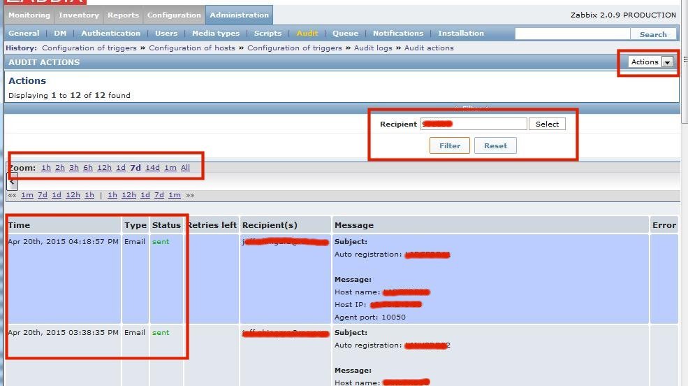

    You can see if Zabbix is sending e-mail from an action by going to Administration --> Audit. Look at the below image.
    - Change the top right dropdown to "Actions"
    - Change zoom level to a period where you know an action should have been triggered (Do this before selecting "Recipient", or recipient may change when selecting zoom level)
    - Change recipient to user who is defined in the action
    - Click the "Filter" Button.
    Any attempted e-mails will show with either a green "Sent" status or a red error status of some type.
