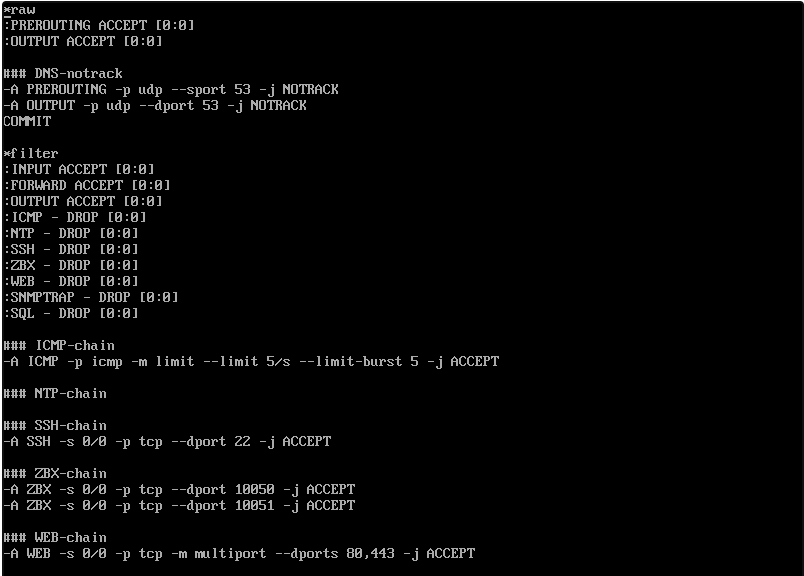

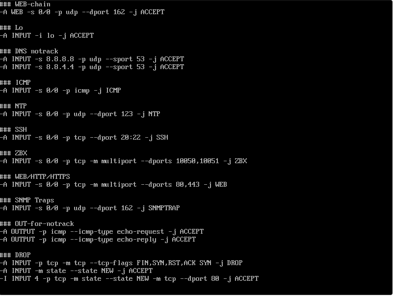

      Unfortunately, the appliance I downloaded using CentOS8 does not have firewalld or nftables running. It also does not run on Apache, it runs on Nginx. I only see iptables as options for me to configure. If stopped iptables service, I still get the same behaviour. I've also tried to modify the Nginx conf files to see if I can get something right. I'm sharing here for reference:
      Here is the iptables file itself

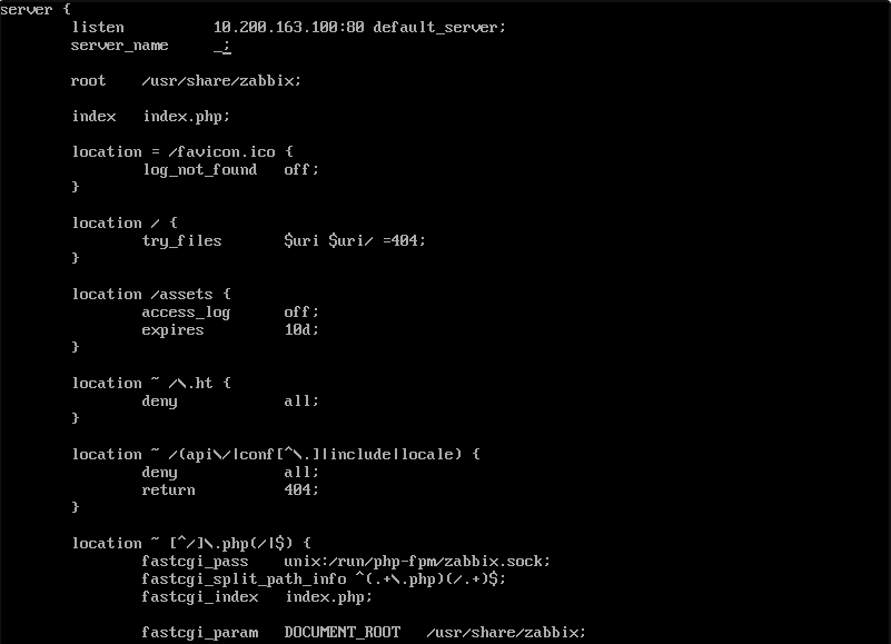

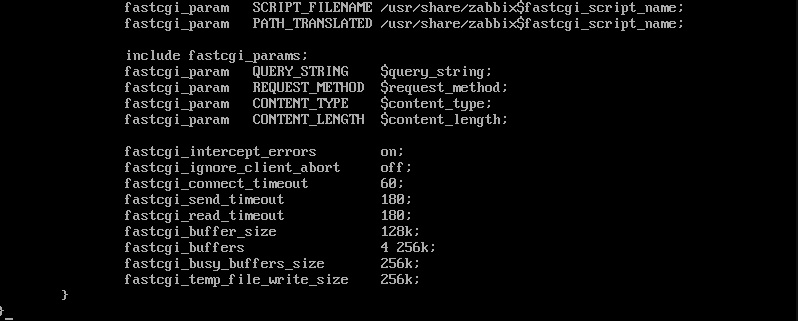

      This is the zabbix.conf file under /etc/nginx/conf.d/zabbix.conf
      Maybe with your knowledge you can spot something wrong?
