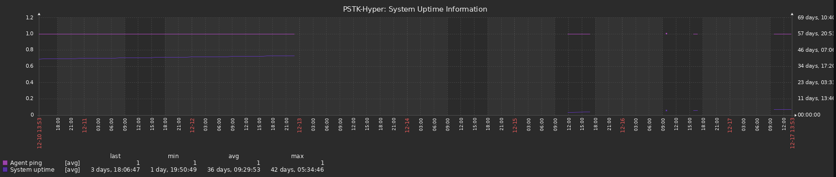

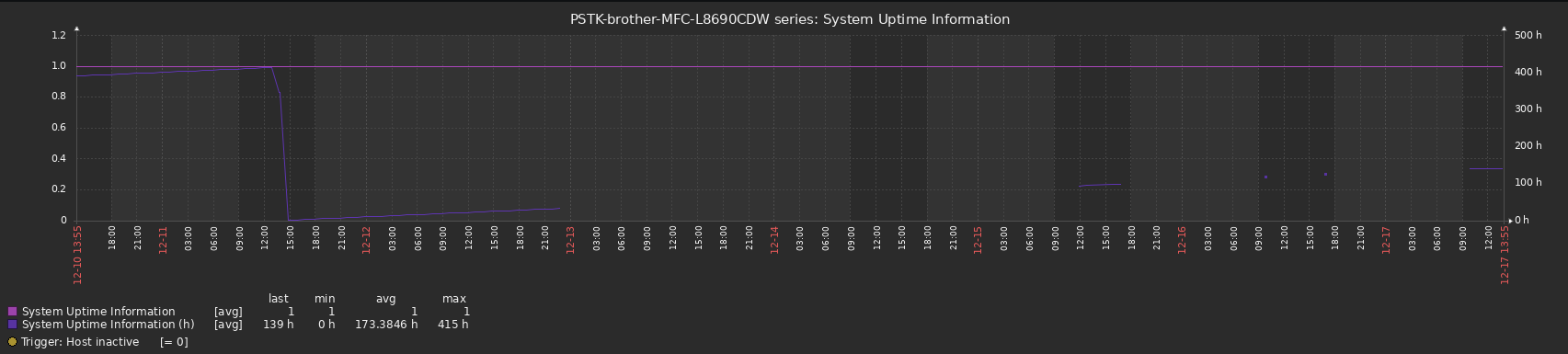

as of recently one of our Zabbix proxies has stopped working properly. According to the graphs, the problem occurred after the last automated reboot of the virtual machine.
Since then only simple checks on the agents the proxy is monitoring have been delivering data as expected. The other items that use Zabbix agent or SNMP have only delivered their data at most once after each reboot of the proxy, then stopped completely without an error in the logs or web interface.
