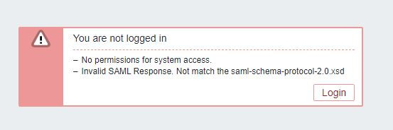

    Hello all,
    I was wondering if anyone else had issue trying to use saml with AWS SSO? in this case i am receiving the following error .
    You are not logged in
    • No permissions for system access.
    • Invalid SAML Response. Not match the saml-schema-protocol-2.0.xsd
    This is when I click on the link in AWS SSO portal.
    Any assistance would be appreciated!

    I think the first error is the result of the second. I searched for "Not match the saml-schema-protocol-2.0.xsd" and it seems the consensus is that it can be several different things, problems with signing assertions, not including any user attributes. You may just have to work thru those things one by one.

      Thanks i did the same, what I was hoping for was a some places to start, I looked at auth.log zabbix-server .logs and didn't see anything to help.

        I tried all of those as well , what's hampering me is the lack of logging, i can't really see what the issue is as the error messages are vague at best.

      Through sheer luck i was able to get it working by creating a sp-metadata file and creating user attributes that were set to use email. And as well setting up index_sso.php to work with sso.
