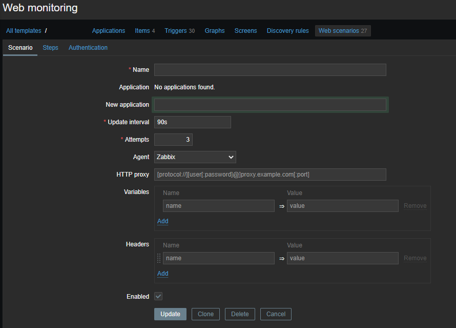

      I have two different servers monitoring the websites as pictured. Both servers say at 2000 there is no data for these websites. The other items that are monitored, CPU usage, etc, are all still reporting correctly. The setup I have on most of websites is below
