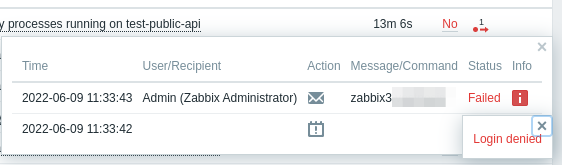

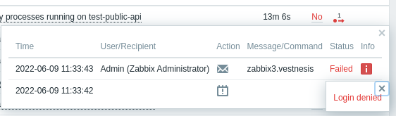

      Zabbix alerts are not working starting from 6 june. Error in zabbix log is like that:
      648:20220609:115231.083 failed to send email: Login denied
      In frontend is like that:

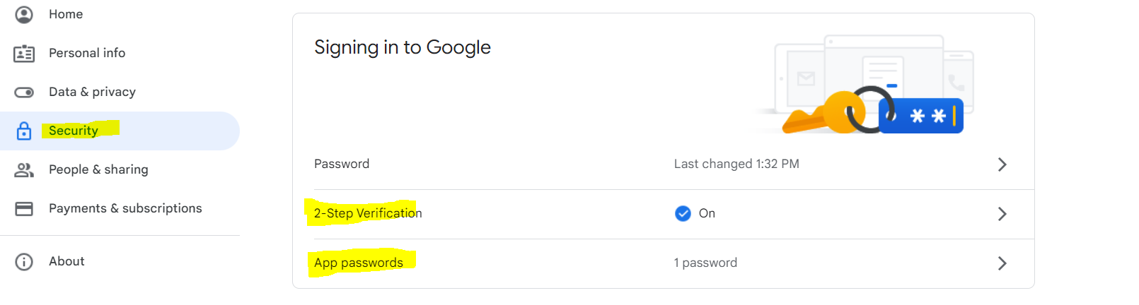

                • Vikas Negi
                  Vikas Negi commented
                  Hi There
                  See the below screenshot attached by myself from the google account where you can enable 2 factor and also generate a password for your app.
                  To create password choose email and give custom app name such as Zabbix (worked in my case)
              • Vikas Negi
                • Nov 2022
                Hi All
                1. Click image for larger version
ID:	455205​Click image for larger version
ID:	455206​Setting you need to have for gmail to work with zabbix highlighted in yellow
