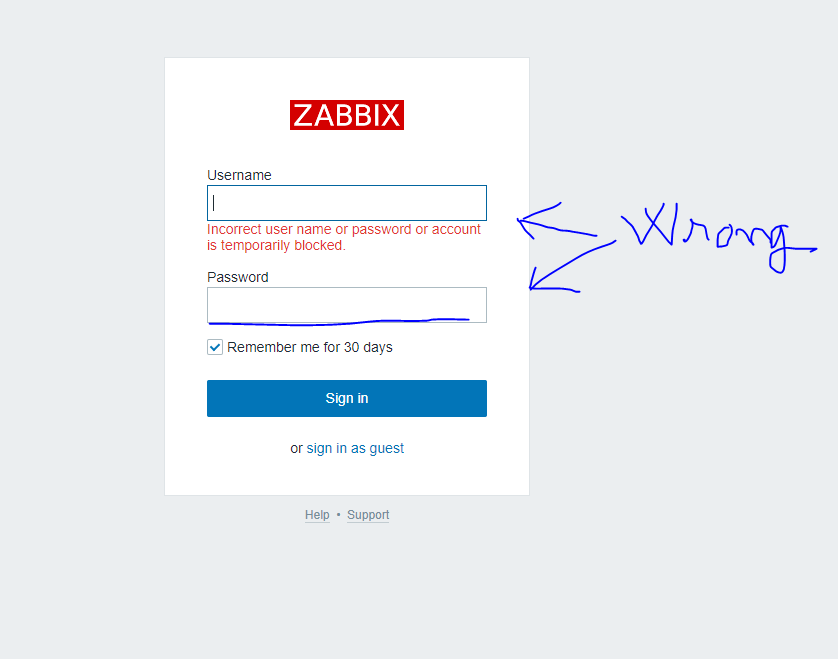

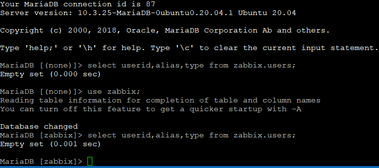

    As you know, The new version of zabbix don't support with CentOS 7. So, i want to migrate database from CentOS to Ubuntu. But, after import database to Ubuntu bionic, my table zabbix.users is empty. Can i create userid in zabbix.users ?
    When table zabbix.users is empty, i can't log in zabbix web by user: Admin & password: zabbix.
    The problem's happening when i finished install zabbix-server, import database and go to step login zabbix on web.

    If Zabbix worked on Centos, it had a user table, it it's not there on your Ubunto system, you have a db migration problem. Check your other tables, do any have content? How did you migrate the database?
    • vu_poppy
      • Dec 2020
      Hi LenR,
      On CentOS, it available a user table. But, i don't know when import and export to Ubuntu. it missed that table.
      I run command export :
      - mysqldump -uzabbix -p > zabbixdata.sql
      and import:
      - mysql -uroot -p zabbix < zabbixdata.sql
      I also try to export by PHPMyAdmin. It same error.
      • Atsushi
        • Aug 2013
        • 2028
        Have you checked the contents of zabbixdata.sql?
        I think it's better to explicitly specify the database name when you get the dump.
        ex.
        $ mysqldump -uzabbix -p zabbix > zabbixdata.sql

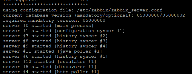

          Thanks Atsushi 's comment. I try to rebuild other zabbix-server. After input database, i receive error in below. I can't start zabbix-server.
          • Atsushi
            Atsushi commented
            The message in the image file you pasted is not an error. If Zabbix server cannot be started, please show the log of the error part.
