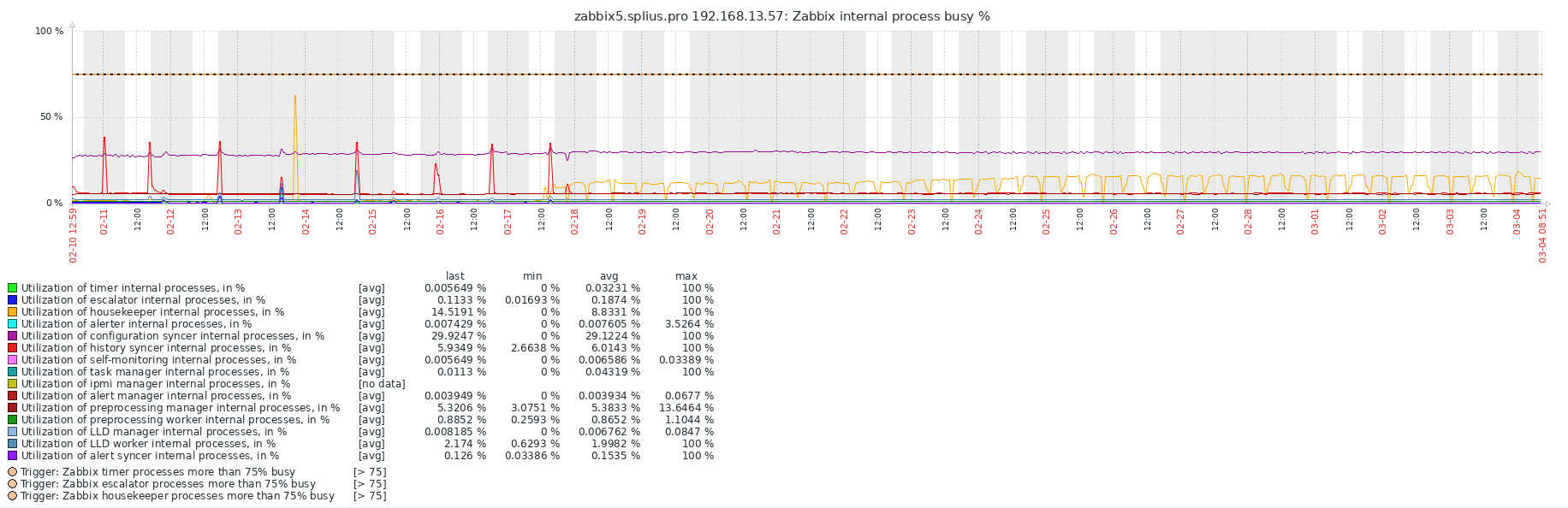

      • Hitman
        • Dec 2015
        I also have the same problem with zabbix 5.0.8 and MariaDB 10.3.27, I will try to downgrade MariaDB to 10.3.25 to confirm if it works.

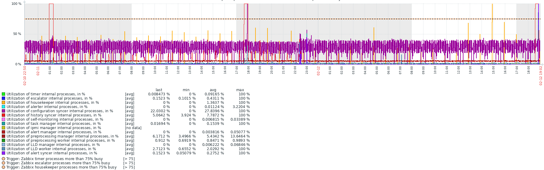

        • Hitman
          • Dec 2015
          I can confirm, that after downgrading MariaDB to 10.3.25 problem is resolved, no issues for over 2 weeks now.
