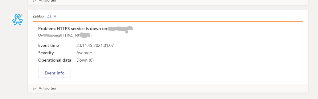

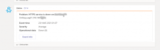

we have a Problem with MS Teams integration. At the moment we post message to a channel, that is working fine.

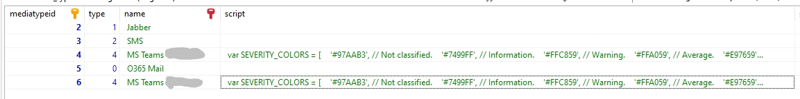

Is there a "URL Syntax" Check in zabbix an the "new" format is not valid?
I already created a new webhook, same problem. The team/channel is created by a user with a valid "business standard" licence.
Can some assist here? Were to begin troubleshooting? I think this is zabbix related, but i cant find the "regex" for the Teams webhook URL.
