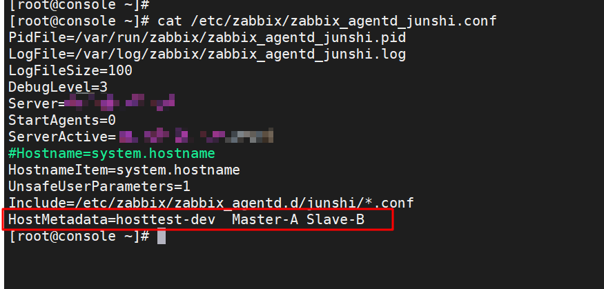

    Hello everyone,
    please tell me how to add the configuration items of the HostMetadata configuration item on the agent side to the alarm information through the alarm information?
    REALLY NEED TO HELP!
    Thanks for everyone

    Yep,you are right
    And I knew it from manual, so what should I do? How to get a value from agent? No Hostname item

      The current situation is that I want to set a value on the agent side. This value may be very long. This value is a string of strings automatically generated by the script when installing the agent, and I want to quote this string in the alarm message. what should I do?
      It should be noted that the monitoring adopts active monitoring method. I imagined using macros or sending parameters to the server, but these are not good methods.
      thanks again

            Do I get this correctly, you want to use things from Metadata in alarms generated by host?
            "Host metadata is used only at host autoregistration process (active agent)."
            So... You can do autoreg operations based on this data, but there is no option to use it directly in any alarms.
