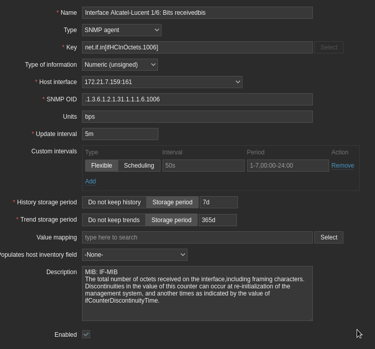

    Sorry if the solution I provide is very basic, I simply cloned the item, changed the key to the one detailed in the image and the oid to the one from the 64bit counters. And I don't care what a cacti reports for the same interface of the same device. The only difference I find with your data is that the type of information is numeric (unsignned). I hope it helps you.

    • monoterrible
      • Feb 2024
      and the interval is 5 minutes
