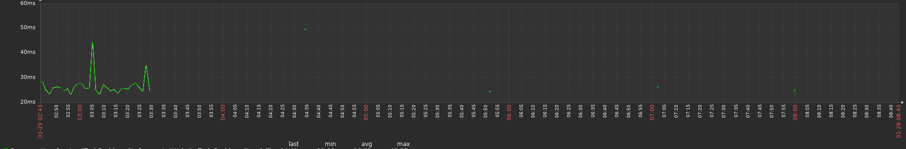

    Last night around 0300 several data points stopped recording data.
    I had this issue before, but i thought it was an IO error. I didn't find IO errors like I did before.
    I restarted the the mariadb and checked the status:
    $ mysqladmin -u zabbix -p status
    Uptime: 915 Threads: 26 Questions: 53833 Slow queries: 0 Opens: 127 Flush tables: 2 Open tables: 153 Queries per second avg: 58.833
    Not all of the servers reporting to Zabbix are doing this, and not all data points on a single server are doing this.
    I'm been searching forums and will continue, but I haven't found anything that has pointed me in the right direction yet. Anyone seen this before?

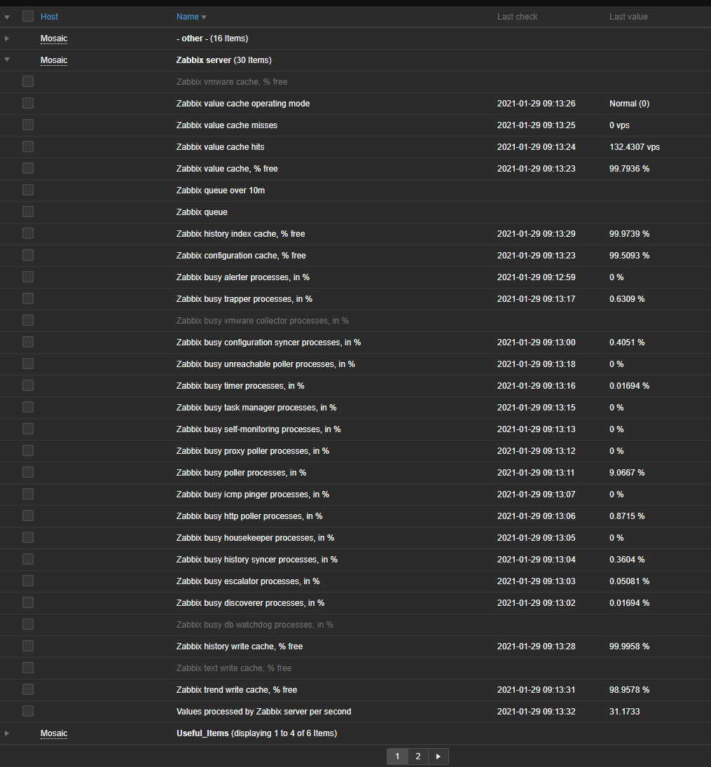

        And My Zabbix Server Statistics via the Zabbix Server Template
        • sfereday
          • Jun 2020
          • 30
          The last two images would be when the server is working it seems. The issue has randomly stopped.
