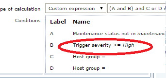

    HI
    We use Zabbix 2.4.2

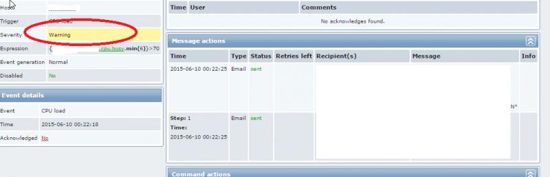

    We got problem with Actions. We define Action to get mail when Trigger severity is >= High but We also receive it When severity is warning
    See attachments
    Best regards
    Pawel
