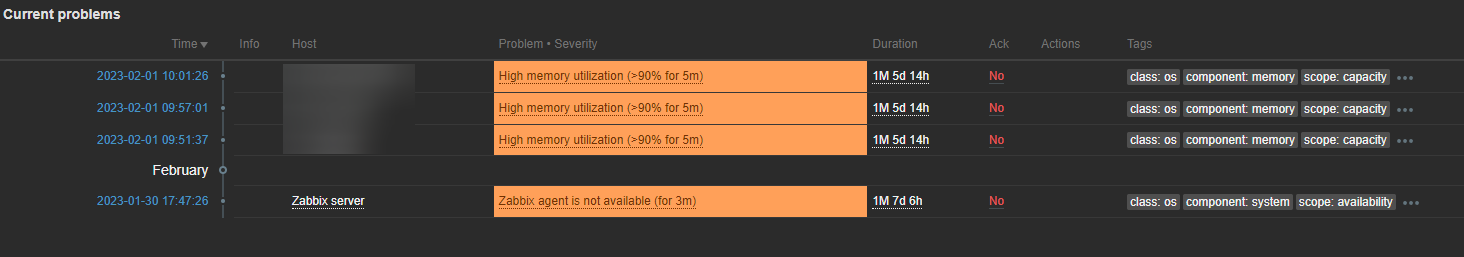

    Hello, I have been having the same issue. My front end UI of zabbix dashboard shows all the LXC Containers in my proxmox servers are "High memory utilization"
    All other metrics work except for this memory issue.
    I came across this guide to resolve the issue but didn't understand how to go about it. I'm not an expert in these matters q.q
    Please let me know if there are any easy to follow guide or video that I can follow to resolve this issue.
    Thank you in advance
    PS: The Zabbix server itself shows as inactive but that's another issue that I wasn't able to resolve​
