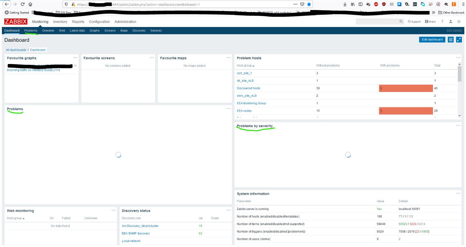

    Good Day!
    As seen in the attached, a client is complaining that since yesterday, they noticed that the Dashboards and Monitoring-> Problems section no longer seems to work (specifically “Problems” and “Problems by severity”) - see attached
    The user claims that no changes were done on the admin node so not sure why they are not seeing problems described in those sections.
    What was already tried:
    • Zabbix and httpd services restarted
    • Admin node server restarted several times without success
    • all related services are up and running

    So it seems from the output above that things should be running/monitoring fine. What I was going to ask/send them was in order to narrow this issue down what type of user was running/logged into Zabbix? Is it a guest account? A regular user? Is this happening with every zabbix user or just one specifically? Just out of curiosity, if it is a Guest account maybe they can check/set permissions to access the host information registered as a Guests user group (i.e. Select Administration -> User groups 2. Guests group click 3. click Permissions tab)?
    I also was going to ask them to provide the latest zabbix server logs when reproducing the issue seen in the picture above (such as the zabbix_server.log & zabbix_agentd.log)?
    Does anyone have any additional thoughts on what to check/restart?
    Thank you!

    Hello.
    Something changed, do not trust that nobody did not made any change.
    Maybe setings of this two part of dashboard changed (severity to be displayed for example) or some permittion changed etc.
    You can check Reports - Audit tab too for chages on Zabbix.
