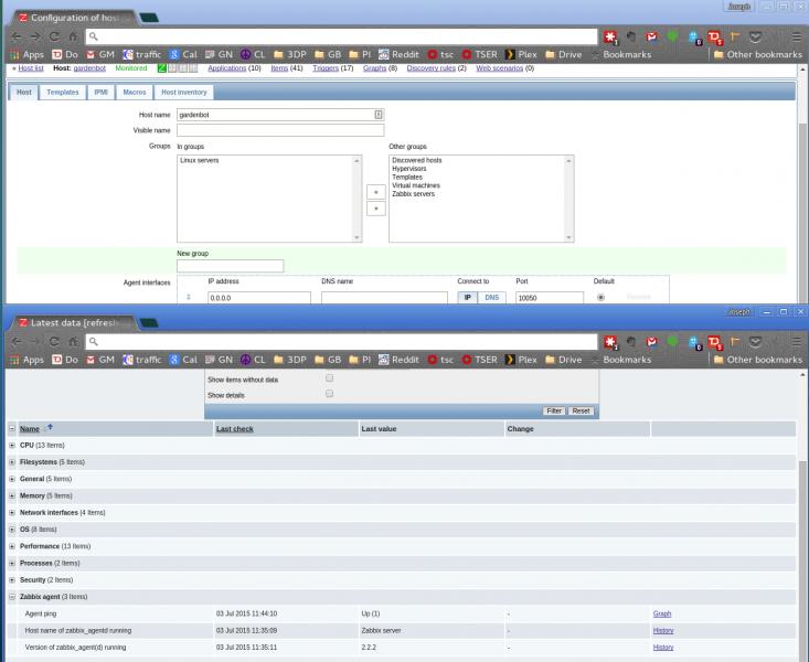

    Heres a screenshot everything seems to be configured properly yet zabbix shows hostname as zabbix server not gardenbot
