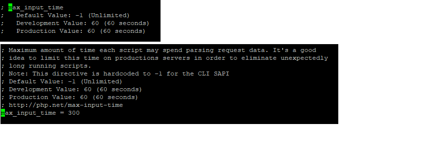

        I have set it to 300. - But I have several php.ini on my server. Maybe you too and you checked the wrong one.

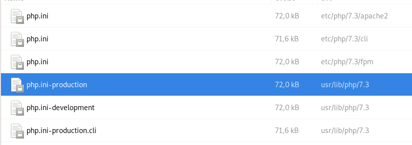

          I also have a debian buster - and look how many php.ini:
          /etc/php/7.3/apache2/php.ini
          /etc/php/7.3/apache2/php.ini.backup
          /etc/php/7.3/cli/php.ini
          /usr/lib/php/7.3/php.ini-development
          /usr/lib/php/7.3/php.ini-production
          /usr/lib/php/7.3/php.ini-production.cli
          In my case the first was the right one, but I compiled and installed zabbix server from the sources.

            I searched and found 3 php.ini. I changed the value on all of them, but no change.
