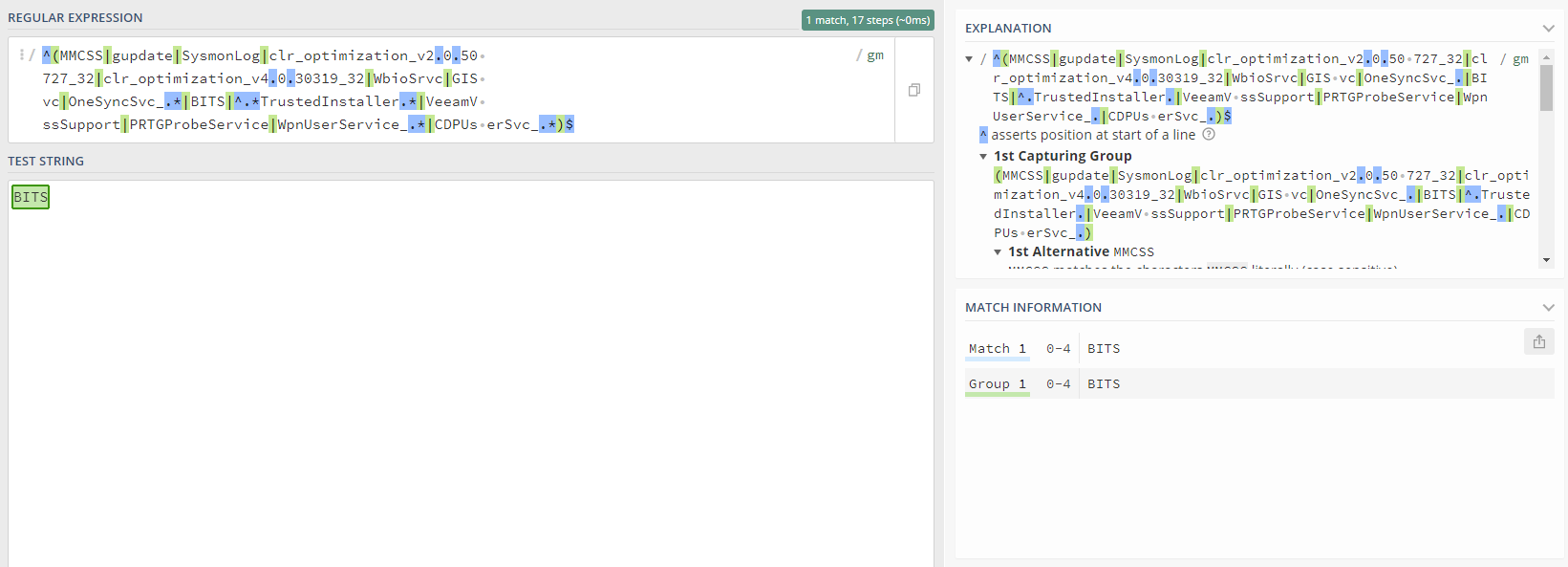

        Did you try your regex with a few of your service names on https://regex101.com/ for example?
        And I would give it a try using that expression in the filters.

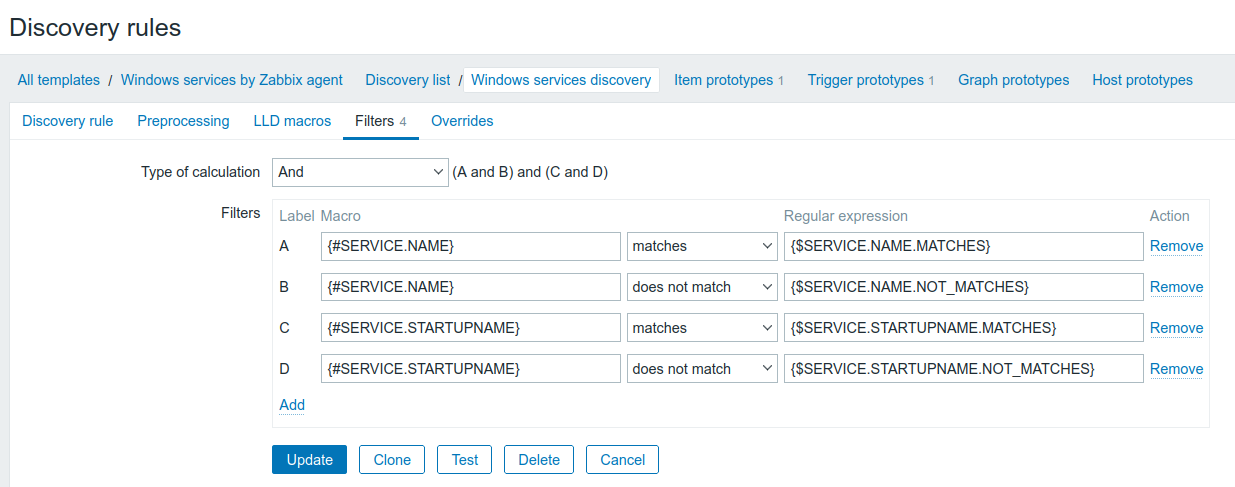

                        In my 5.2.4 version I can see the following filters in the discovery rules for windows services:
                        Those refer to MACROS! - You can see this by the "{}" enclosed expressions and the # or $ sign (built-in vs user defined macros). So you need to look at the template level macros or host macros:

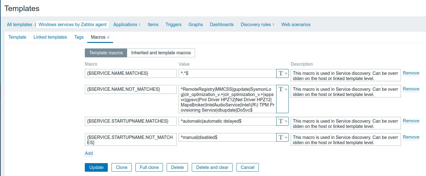

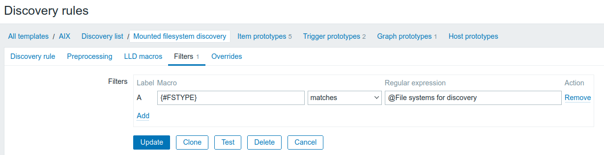

                        If you want to refer to your global expressions you would have to use @ - like this:
                        So to sum up: From current knowledge, I think you can put your favorite quote there into the global expression and it would not make any difference because not referenced by the actual templates.
