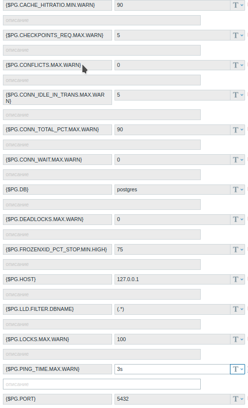

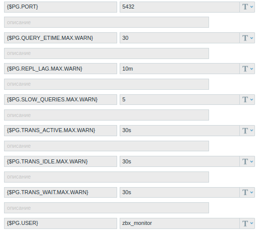

    I have a problem setting up a template Template DB PostgreSQL.
    For setting it I used manual:
    but, I received error:
    error reason for "Zabbix server pgsql.ping.time["{$PG.HOST}","{$PG.PORT}","{$PG.USER}","{$PG.D B}"]" changed: Preprocessing failed for: 1.Time: 0.573 ms
    At the same time, the command from the console is executed successfully:
    zabbix_get -s 127.0.0.1 -k 'pgsql.transactions["127.0.0.1","5432","zbx_monitor","postgres"]'
    {"idle":0,"active":0,"waiting":86407.439003,"pr epa red":0}
    zabbix_get -s 127.0.0.1 -k 'pgsql.ping["127.0.0.1","5432","zbx_monitor","postgres"]'
    127.0.0.1:5432 - принимает подключения (accept connections)

    pg_hba.conf
    host all zbx_monitor 127.0.0.1/32 trust
    host all zbx_monitor 0.0.0.0/0 md5
    host all zbx_monitor ::0/0 md5
    System:
    zabbix_server (Zabbix) 5.0.5
    Debian 10.6 x64
    Perhaps someone knows where to look for the error?
    I'm already stumped
