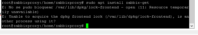

                  I'm trying to isntall the package through this command line: sudo apt install zabbix-get but I got the attach message.
                  Kind regards
                  • mwildam
                    • Feb 2021
                    • 72
                    But this is a totally different issue and does not have anything to do with zabbix. Your problem is, that a package manager - such as aptitude or the graphical synaptic or the gnome-software manager - is open and blocking the access to the package manager. Close it and you can proceed with your install.
