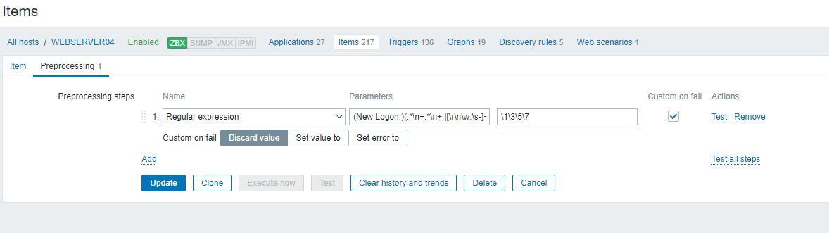

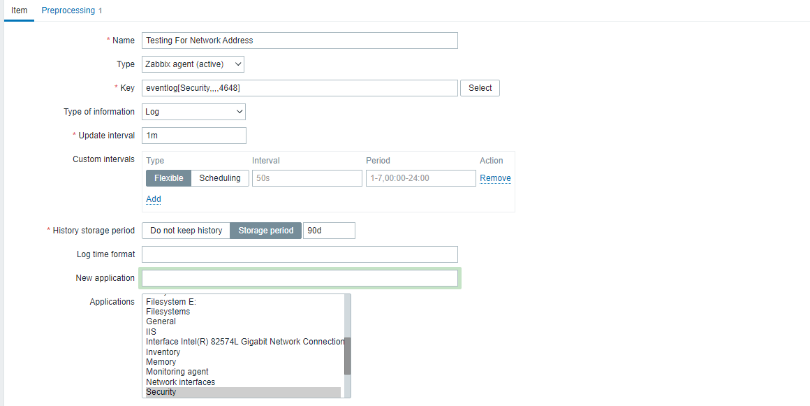

    Hello everybody;
    I create item eventlog(Security,,,4624) and preprocessing then regular expression create. New Logon:abcd. It is okey but i adding Source Network Address is not runnig;
    Working regexp; https://regex101.com/r/1N1pOy/1 ; this regex for zabbix output \1\3 => New Logon:mcanbaz => it is working
    Not working regexp; https://regex101.com/r/SjWti4/1 ; this regex for zabbix output \1\3\7 => New Logon:mcanbaz 192.168.0.10 => it is not working

    Hello ester, could you please post your exact configuration? I will try to recreate this.

      eventlog[Security,,,,4648]
      (New Logon(.*\n+.*\n+.|[\r\n\w:\s-]+)Account Name:\s+((?i)\b(?!System)[a-zA-Z0-9]+)(.*\n+.*\n+.*\n+.*\n+.*\n+.*\n+.*\n+.*\n+.*\n+.* \n+)(Network Information(.*\n+.*\n+.|[\r\n\w:\s-]+)Source Network Address:\s+((?i)\b(?!System)[\w.]+) \1\3\7

      • Sebastian
        • Jul 2020
        • 33
        You can check with the following settings:
        I was able to recreate it on my installation and got it working well.
        Key:
        eventlog[Security,,,,4624]
        RegEx:
        New Logon:[^*]*Account Name:        (?!System)(.*)[^*]*Network Information:[^*]*(\b(25[0-5]|2[0-4][0-9]|[01]?[0-9][0-9]?)(\.(25[0-5]|2[0-4][0-9]|[01]?[0-9][0-9]?)){3}\b)
        New Logon:\1 \2
