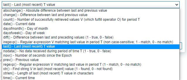

        Thanks Hamardaban for your response but I don't see custom in the functions. They are all predefined.
        • Hamardaban
          Hamardaban commented
          I didn't write about functions, but about preprocessing.
        • Vieypul56
          Vieypul56 commented
          Absolutely, it was my mis-interpretation.
