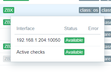

        • Jun 2023
        Agent Version - 6.4.3 on Ubuntu 22.04
        /etc/zabbix/zabbix_agent2.conf contains
        AllowKey=system.run[*]
        Plugins.SystemRun.LogRemoteCommands=1
        Via a 6.4.3 proxy on Ubuntu Linux
        All Green and Data flowing
        Still, Get the following results from Detect Operating System.
