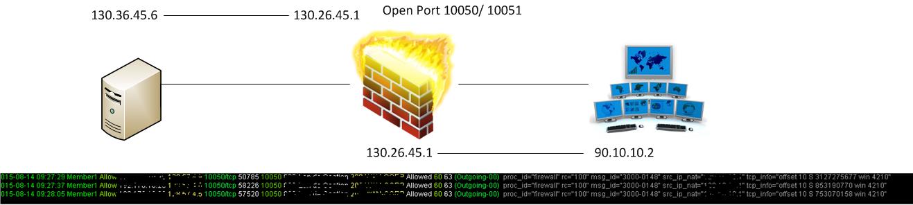

      Agent Zabbix on NAT/Firewall
      Hello, thank you very much, I checked this and for That reason I think I need some information on, configuring Zabbix agent or on the same server for Zabbix configuration between FW and Nat
      I add diagram, please What additional or different configuration takes place at each end ?.
      Greetings and thank you.
      • jamesNJ
        • Jun 2015
        • 103
        So what ip address does you 90.10.10.2 client connect to for active check?
        Does the zabbix server get a NAT address, or do the clients get a NAT address ... or both?
        It might also be important to know which side (if both maybe) are masqueraded in a way that hides many hosts behind a single IP address ... there are many ways to use NAT.
        At the end of the day, you need to be sure what address is used to connect form server to client, and then also from client to server.
        You will need to figure out precisely how each side sees the other side. If you are using active checks, it might be helpful to set the zabbix agent on the zabbix server to permit connections from anyone (see Server= parameter) and then use zabbix_get from the client to probe items from the master. That is intended only to help troubleshot to make sure that your connections work as expected across the firewall. It may also be helpful to run tcpdump on zabbix server to make certain the IP address you are expecting is trying to connect.
        The zabbix client and server configuration on each side is usually pretty easy ... it kind of sounds like you either have a blockage at the firewall or perhaps using the worn IP addresses at each side for communication from client to server.
        Sorry I can't be more specific ... debugging NAT and firewall configurations can be tricky.

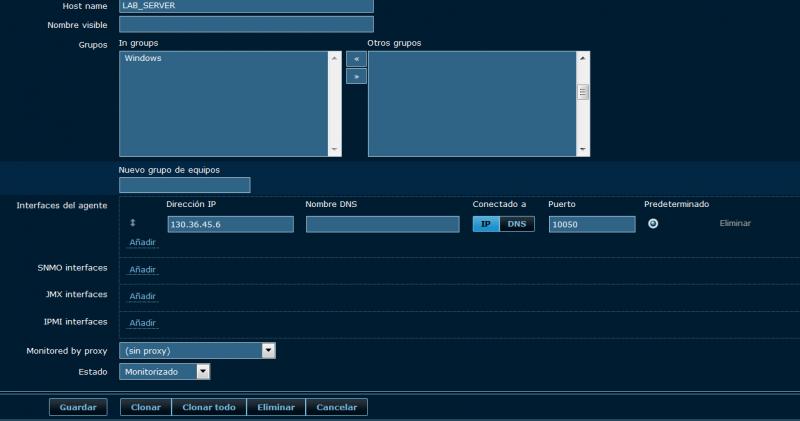

          The configuration of Zabbix server hand I have done so I attached.
          Are there any additional settings I need? . I do not understand that it refers to active check, do you could specify a ?

            Server Zabbix
            • jamesNJ
              • Jun 2015
              • 103
              Let me see if I understand....
              Your zabbix server is 90.10.10.2
              Your agent is 130.36.45.6
              On the agent's network, the NAT address of 130.36.45.1 is the zabbix server
              You are trying to configure zabbix server to use passive zabbix agent connection so that zabbix server connects to the agent to pull data.
              Please let me know if that summary is correct.
              Assuming that is correct, the agent example and screen should should work for zabbix server passive checks. The server Host configuration specifies to connect to 130.36.45.6, and the agent configuration (Server=) defines what IP address the zabbix server is coming in as.
              Active checks (where agent connects to zabbix server) will not work. Your ServerActive= configuration is bad. ServerActive should = the zabbix server IP address which is 130.36.45.1.
              I hope this helps some. If my assumptions are correct, try to use zabbix_get on the zabbix server to probe some simple data from the client like agent.hostname. That should help with passive checks. Active check testing would be more tricky; you need to be able to test that your firewall(s) are allowing traffic to go from the agent machine to there server.
