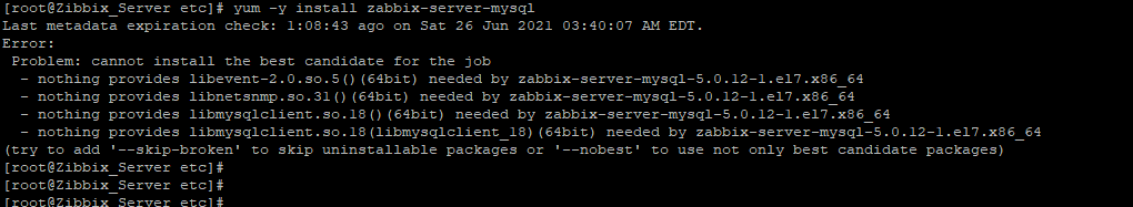

      I'm a newbie,
      I am having trouble installing Zabbix server on Centos 8.0 as shown below. please just help me fix this error.
      Thank you so much!

          Hi anhdv,
          Did you install the zabbix-release package for RHEL 7 on CentOS 8? Since the repository for RHEL 7 and the repository for RHEL 8 (CentOS 8) are different, please install the zabbix-release package for RHEL 8 on CentOS 8.
          As a procedure, first remove the already installed zabbix-release package. Then install zabbix-release package for RHEL 8 and clear the repository cache.
          # dnf remove zabbix-release
          # dnf install https://repo.zabbix.com/zabbix/5.0/rhel/8/x86_64/zabbix-release-5.0-1.el8.noarch.rpm
          # dnf clean all
