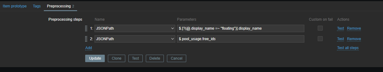

    18316:20210630:082911.477 Got signal [signal:11(SIGSEGV),reason:128,refaddr:(nil)]. Crashing ...
    Last change in zabbix added the preprocessing step "1" as seen in the screenshot

    • johansenfa
      • Nov 2020
      • 11
      I have dumped the database and searched for the mentioned string, removed the entries and could start zabbix_server without any further issues:
      mysql> delete from item_preproc where params like '%display_name%';
      Query OK, 286 rows affected (0.01 sec)
      mysql> delete from item_rtdata where error like '%display_name%';
      Query OK, 286 rows affected (0.08 sec)
      mysql> delete from lld_macro_path where path like '%display_name%';
      Query OK, 1 row affected (0.01 sec)
      Seems like it make sense to open a bug report?!
      • johansenfa
        • Nov 2020
        • 11
        Bug Report
