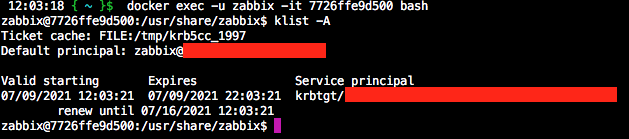

    I configured the Zabbix 5.4.2 per the documentation, created a zabbix user on the kerberos realm, created the keytab, tested in the container with the curl -v --negotiate -u : http://example.com and it's working as expected.

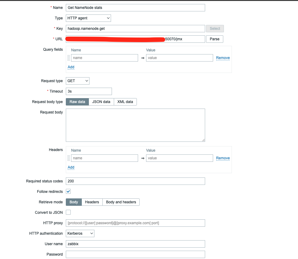

    After that i tried to configure the Hadoop HTTP Agent built-in on the Zabbix 5.4.2 but it was unsuccessful.

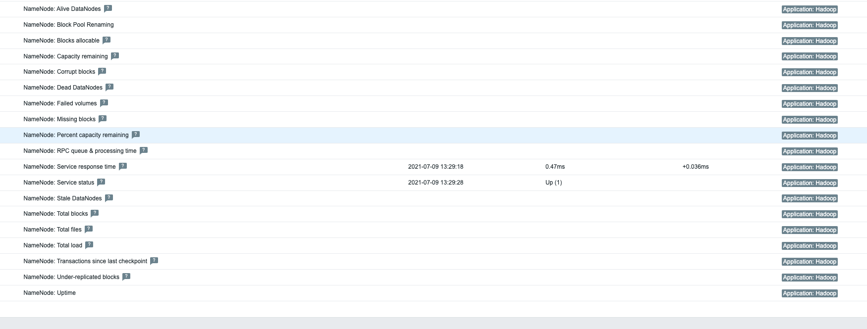

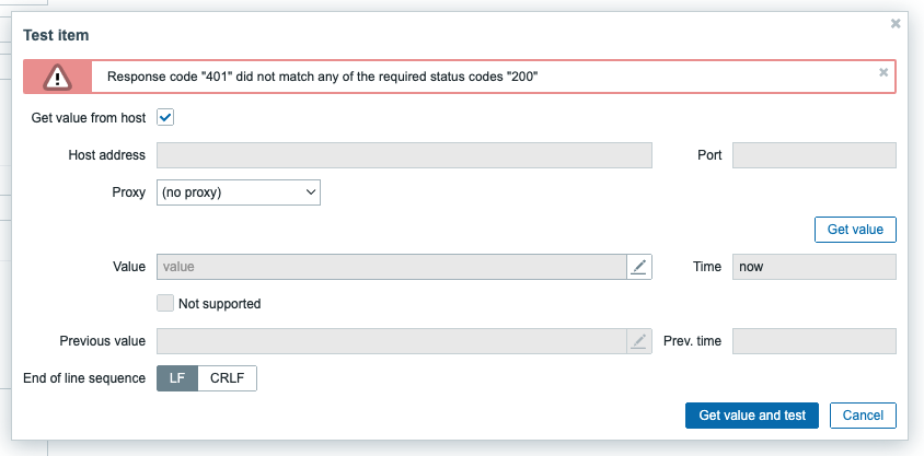

    The NameNode and ResourceManager host and port are correct because the status are UP(1) but the rest of the monitorization is giving me 401 Unauthorized and i can't find why.

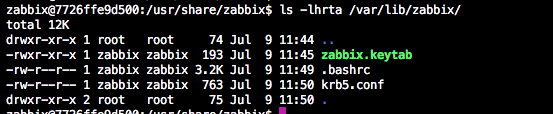

    - enabled the home directory for user zabbix in zabbix-server container, copied the keytab, krb5.conf and added a .bashrc with the "kinit -kt <keytab> <user>"
    - tried the kinit with user root, user zabbix, different permissions and files in /etc/apache2/ or /etc/
