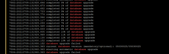

          When I started the Zabbix Server, I ran "cat /var/log/zabbix/zabbix_server.log | grep database" to check the DataBase update, but I noticed it failed (even rebooting the server):

            Right, I have an idea: Presumably the ignored tables are now missing from the database, so the upgrade cannot proceed. So if you can get the missing tables (in 5.2 format) created somehow, you should be good to go.
            Or, take a full dump of the previous database and then remove the data statements from the tables that you want to purge in the dump, before importing it.
            Or, install first 5.2 with the default database creation script in 5.2, then import the config-only dump, and finally upgrade Zabbix to 5.4.
