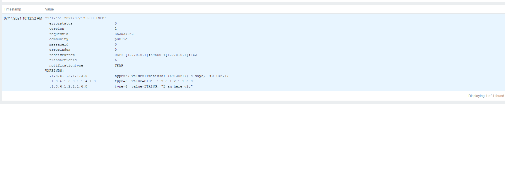

    When I using ` snmptrap -v2c -cpublic 127.0.0.1 '' SNMPv2-MIB::sysLocation.0 SNMPv2-MIB::sysLocation.0 s "I am here v2c"`
    I can see the traps both in /tmp/zabbix_traps.tmp, looks like below output:
    22:12:51 2021/07/13 ZBXTRAP 127.0.0.1
    PDU INFO:
    errorstatus 0
    version 1
    requestid 352534932
    community public
    messageid 0
    errorindex 0
    receivedfrom UDP: [127.0.0.1]:59560->[127.0.0.1]:162
    transactionid 6
    notificationtype TRAP
    VARBINDS:
    .1.3.6.1.2.1.1.3.0 type=67 value=Timeticks: (69130617) 8 days, 0:01:46.17
    .1.3.6.1.6.3.1.1.4.1.0 type=6 value=OID: .1.3.6.1.2.1.1.6.0
    .1.3.6.1.2.1.1.6.0 type=4 value=STRING: "I am here v2c"
    and UI can also see the output.

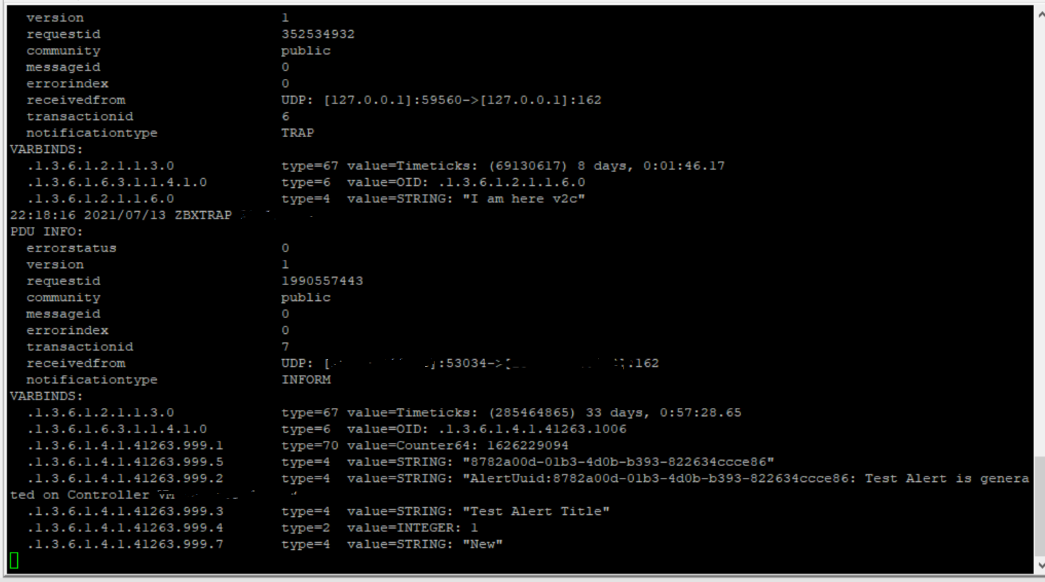

ID:	428132But after I configured Nutanix Trap point to Zabbix Server, and click Test botton. I can only see the Test Trap in /tmp/zabbix_traps.tmp. but the traps can not presented in zabbix UI.

    I have troubleshooted for couple of days. hope somebody can help.Many Thanks.

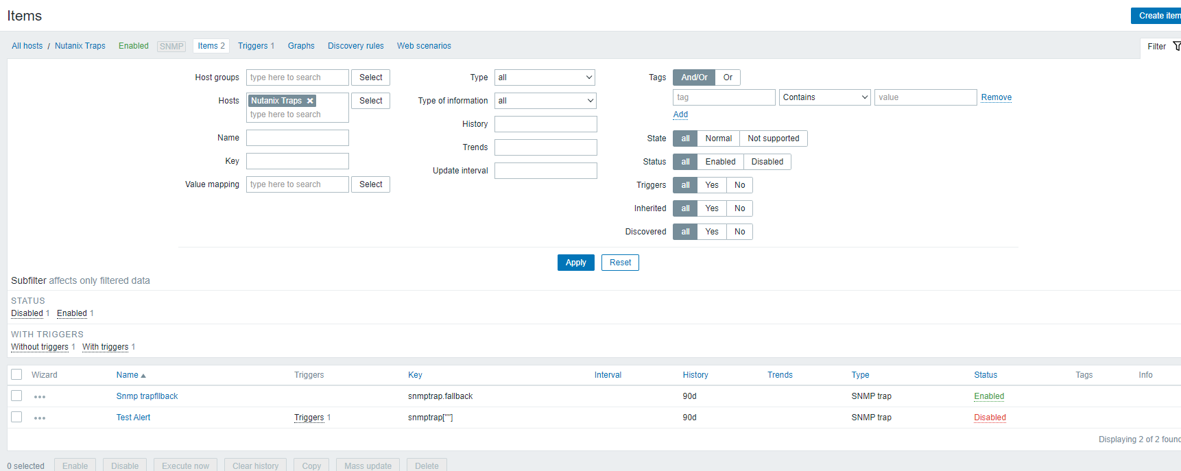

      Is there a host "x.x.x.x"? For this, you need to configure the snmp failback or normal snmp item.
      • Denny
        • Jul 2021
        x.x.x.x is my prism central. A Prism Central manager many cluster. prism central just like VMware vCenter. I have configure snmpfailbck to catchs all log from prism central. Click image for larger version
Name:	snmp trapfallback.png
        • Hamardaban
          Hamardaban commented
          unmatched trap received from "x.x.x.x"
          This means that zabbix could not understand which host this trap is intended for.
        • Denny
          Denny commented
          Is this the root cause why UI can not present traps?
