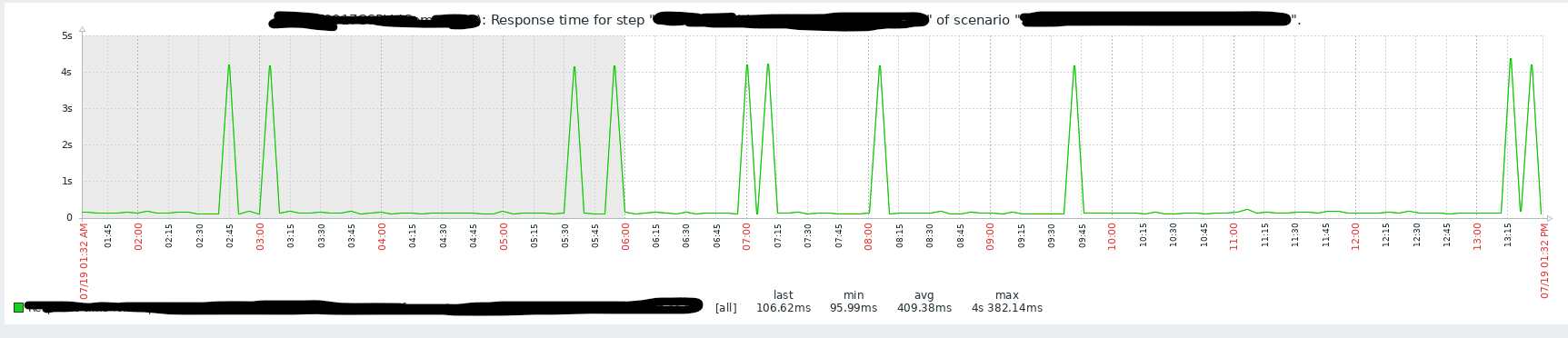

    Hello togheter,
    we moved our Zabbix Server to a new server. At the same step, we changed our enviroment to use docker container (We follow the wiki from zabbix for the installation).
    Since this we recognize some peaks in allour web scenarios. This scenarios belong to different servers on different hardware/network etc.. And every peak is a little bit over 4 seconds on each scenario

    Structure
    4 Docker containers (MYSQL, Zabbix-Server, Zabbix-Apache, Zabbix Java Gateway) on the same host.(2 CPUs, 16 GB Ram).
    Zabbix Version 5.4.1
    I will attach a log output from zabbix-server Container (Log Level 4 for HTTP Poller). Perhaps someone has an idea what there is happening. I have no glue.
    Thanks for the support.
    Kind Regards
    Stephan
