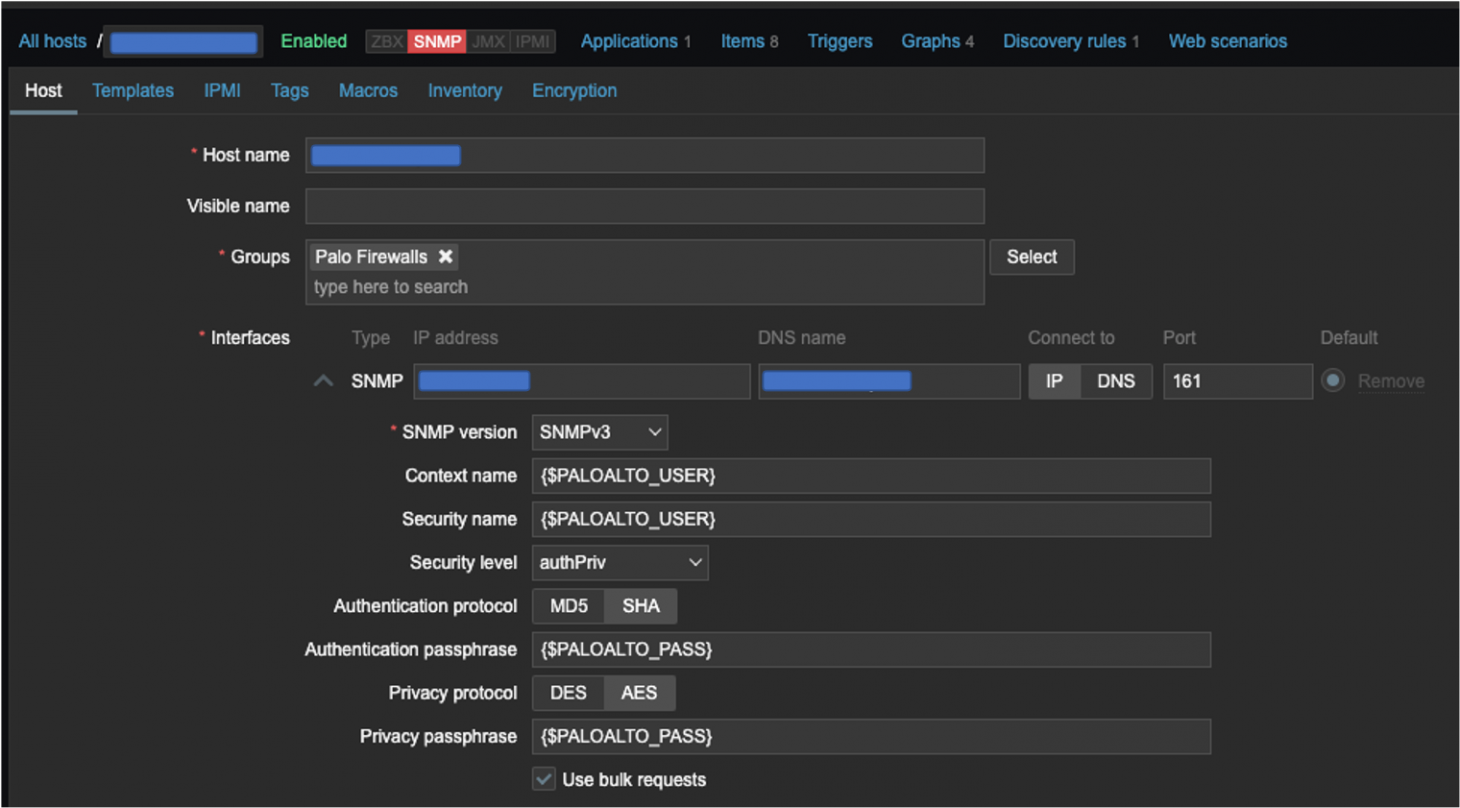

    Hello.
    I have a couple of PA-7050 firewalls that I monitor from Solarwinds Orion via snmp v3. However, when I try to monitor those same devices via Zabbix (SNMP v3), I am unable to get an SNMP response via the Zabbix application. SNMPwalk works fine from the command line on the zabbix server. Seems to happen on Zabbix version 5 and version 3. Has anyone else had this experience or have a suggestion on places to look for a solution?

    In one of my SNMPv3 setup, I've left "context name" blank since it was not available in my monitored host. After that, Zabbix was able to access the SNMP agent.
    Do your firewalls use "context name"?

      Thank you so much for that response! That worked like a charm on zabbix version 5. There were other steps that were probably not necessary but being patient is definitely required. After removing the "context name", I had to unlink the template from the palo alto device. I then had to totally delete the items in the template and then delete the template itself. Once I recreated them and some graphs to show the data, it took some time before the graphs started to populate. I guess zabbix had to finish discovering all of the interfaces. Either way, it is working now on zabbix version 5 and I may try something similar on zabbix version 3. Thanks again!

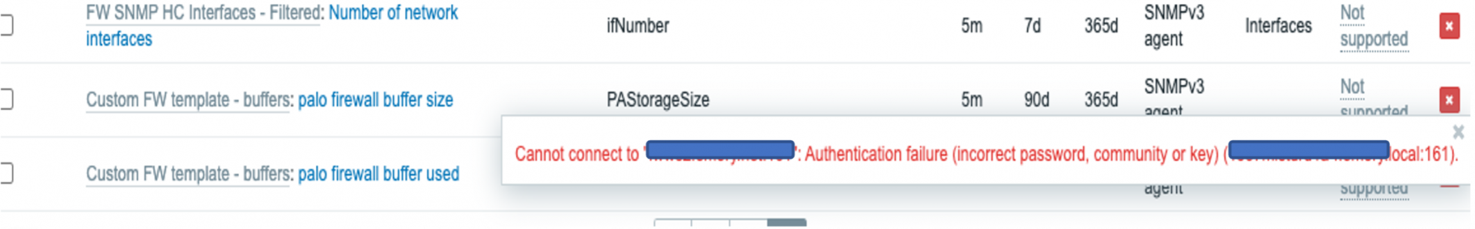

          Hello all,
          What does it mean when there are 2 devices listed in an error message? This is on an "item" setup via template and it fails to collect SNMP data.
          Cannot connect to "somedevicename:161": Authentication failure (incorrect password, community or key) (anotherdevicename:161)
          I have checked for unique "Engine ID's".
          The second device in the parenthesis does not show up ever time. Not even sure it is always the same device.

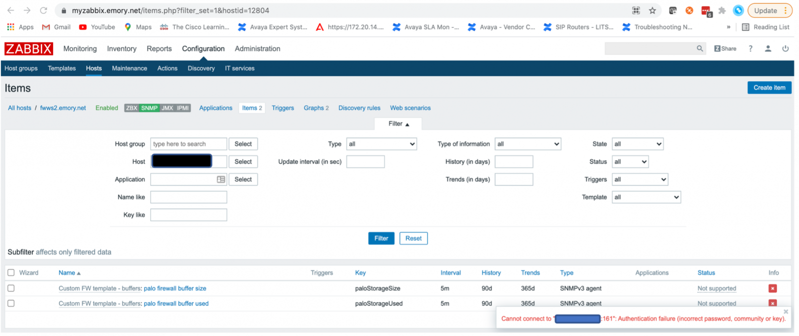

              I actually see the message in the zabbix_server.log and the zabbix webui. See screenshot below.

                I feel like you left me with more questions than answers.
                I was curious when you said there were "2 listed devices in an error message". The image you provided does not show 2 devices, though.
                The error message indicates a possible error with authentication data.

                  The screenshot before didn't have the second hostname in it. Here is a screenshot with the 2 hosts in the error message.
                  Agreed. There is some kind of error with authentication. There are special characters in the passphrase. I use a dollar sign and a percent sign. I need to use both special characters if possible. This setup works in zabbix 5. I am using zabbix version 3.0.31 when the setup fails.
                  I have tried to use macros for the passphrase and typing it in directly. Nothing seems to make a difference. I am following the Zabbix 3 SNMP documentation. It asks that I enter the passphrase on each item as you have stated. Thanks again for helping me with my zabbix version 3 issue.
