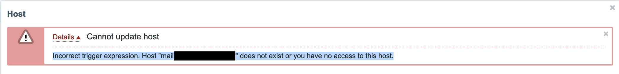

        Hi Team,
        i would like to bring up this topic one more time.
        currently i have a mail server being monitor by zabbix through zabbix proxy.
        Zabbix server <=========>Zabbix Proxy <==========> Mail server
        i have created a custom template which contain items to monitor mail queue and also trigger when it hits more then 200. this template then being attached to the mail server that i want to monitor. However, whenever i try to attach the template, it keeps complaining that "Incorrect trigger expression. Host "mail.server1" does not exist or you have no access to this host."
Name:	Screenshot 2022-04-04 at 10.48.32 PM.png
        below is the sample trigger that i have created.
        min(/Template Zimbra Agent Using Proxy/zimbra.queuestat[deferred],5)>200

          Does your user have access to the group the host belongs to?
          Did you create your template trigger using the Expression constructor?
          • senyapsudah
            • Sep 2020
            • 7
            yes, i'm creating the template using admin account. i believe have all access to the host and group.
            for trigger we create using expression constructor.
            Click image for larger version  Name:	Screenshot 2022-04-05 at 11.39.32 AM.png Views:	3 Size:	146.5 KB ID:	442589
            as additional info, i receive this error only when the host is being monitored by proxy. if i remove monitor using proxy i can add the trigger without any issue. since i create a custom script and load it using userparameter to get the value for zimbra.queuestat[deferred] . do i need to add this script to proxy also?

              i think we can close this already. have found parts of the issue. after enable debug on the web ui. we can see all the SQL queries that has been run. The SQL queries that relate to the error is
              select hostid, host, status from hosts where flags in (0,4) and host="<serverhostname>";
              running the sql query directly to database shows that there is no record of it. after deleting the host and recreate it again we manage to get the correct result. this has been tested few times.
              creating triggers based on the items coming from userparameters now can also be done sucessfully.
