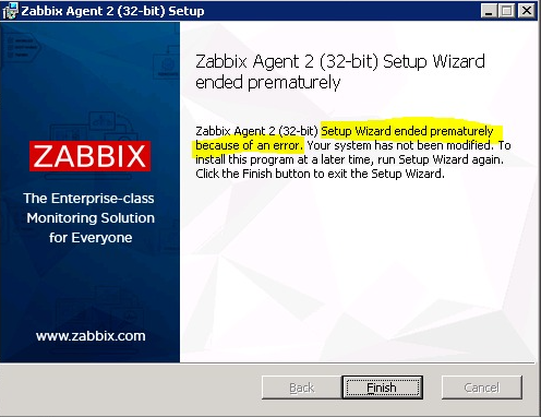

    What´s the correct agent for Windows 2003 R2 Std x86 32bits?
    I am trying https://cdn.zabbix.com/zabbix/binari...86-openssl.msi but I get error (attached).

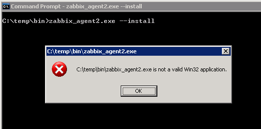

    I am trying https://cdn.zabbix.com/zabbix/binari...ssl-static.zip but i get error (attached).

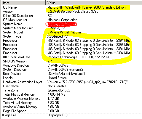

    Windows 32bits evidence attached.

    Since the OS is old, the subsystem version specified in the exe may not be supported. Try using Zabbix 4.0 agent with a slightly older subsystem version.

      Correct. Windows 2003 is supported neither officially nor technically for Agent2, here are the minimal requirements: https://www.zabbix.com/documentation...oncepts/agent2
        Thanks! That worked!
