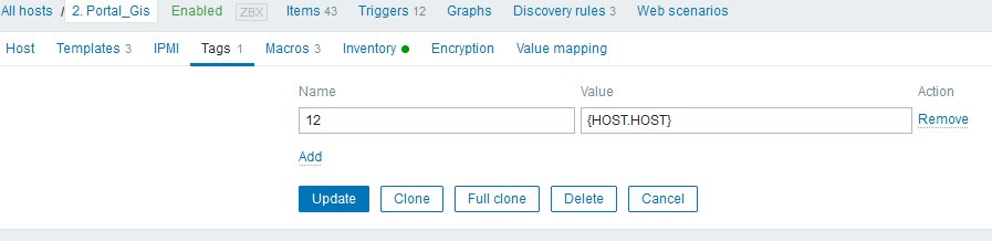

    Zabbix 5.4 using macros for hosts and templates tags
    I am trying to set up some tags at host and template level using supported default macros. The problem is the macro is not resolved and the value displayed is macro itself. I have tried: {HOST.HOST}, {HOST.NAME}, {HOST.CONN}, {HOST.DNS}, {HOST.IP}, {HOST.PORT} or {INVENTORY.*} macros.
    Does anybody know if I am doing something wrong. I used the documentation at: https://www.zabbix.com/documentation...config/tagging.
    Thank you !
  • niq
    • Aug 2021
    Click image for larger version  Name:	Screenshot 2021-08-09 155737.jpg Views:	0 Size:	34.3 KB ID:	429487
    • niq
      • Aug 2021
Name:	Screenshot 2021-08-09 160235.jpg

            • 5004
            It will be resolved to correct value, when your triggers are triggered and you look on "Problems" page. In such "config" pages they will remain as configured.

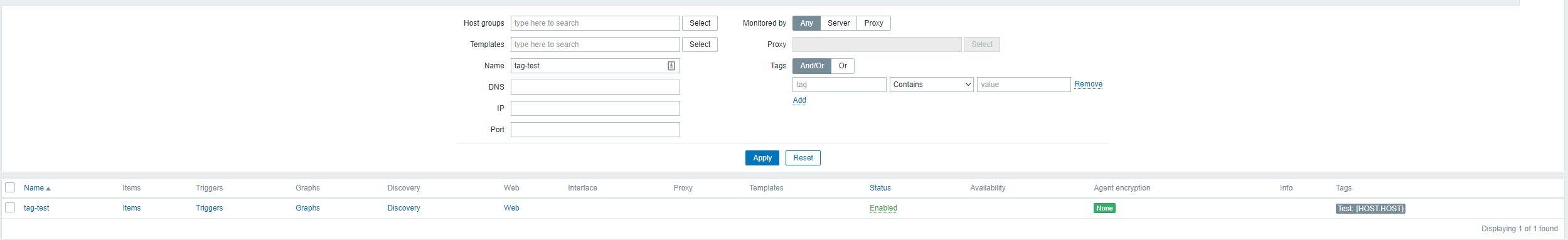

                  • MarGeta
                    • Nov 2021
                    So there is no way to resolve these Macros in the Monitoring-hosts page? From the documentation they make it sound like this should be possible.
                    If we cant filter by resolved macros in the host search it feels quite limited in its use.
Name:	zabbix stuff.png
                    • elmorekevin
                      • Feb 2018
                      • 15
                      This is definitely a limitation
