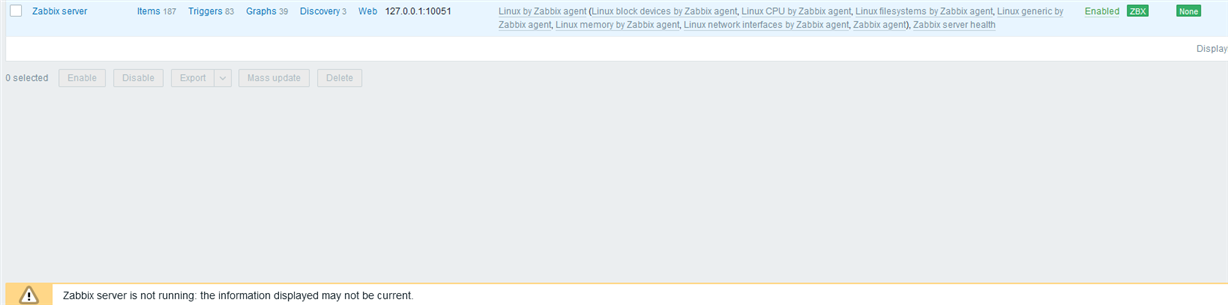

    Hello All,
    Just started to test Zabbix in goal of migrating from Icinga to Zabbix ,installed latest Zabbix 5.4 on Ubuntu 20.04 with Postgres db
    All was working fine for a day and suddenly started to get meesege on the bottom of the we ui ,"Zabbix server is not running " as shown below
    On the server log i can see the server is stopped but can't understand why , log is shown below also ,same as for agent ,btw the firewall is stopped
    any idea how to solve it
    please advice

    5998:20210816:194029.910 7: /usr/sbin/zabbix_server: configuration syncer [syncing configuration](DCsync_configuration+0x1303) [0x5571fc1a1d2d]
    5998:20210816:194029.910 6: /usr/sbin/zabbix_server: configuration syncer [syncing configuration](dbconfig_thread+0x126) [0x5571fc04405b]
    5998:20210816:194029.910 5: /usr/sbin/zabbix_server: configuration syncer [syncing configuration](zbx_thread_start+0x3b) [0x5571fc226906]
    5998:20210816:194029.910 4: /usr/sbin/zabbix_server: configuration syncer [syncing configuration](MAIN_ZABBIX_ENTRY+0xb59) [0x5571fc03078b]
    5998:20210816:194029.910 3: /usr/sbin/zabbix_server: configuration syncer [syncing configuration](daemon_start+0x303) [0x5571fc214f03]
    5998:20210816:194029.910 2: /usr/sbin/zabbix_server: configuration syncer [syncing configuration](main+0x309) [0x5571fc02fb14]
    5998:20210816:194029.910 1: /lib/x86_64-linux-gnu/libc.so.6(__libc_start_main+0xf3) [0x7fdbb55470b3]
    5998:20210816:194029.910 0: /usr/sbin/zabbix_server: configuration syncer [syncing configuration](_start+0x2e) [0x5571fc02e92e]
    5988:20210816:194029.912 One child process died (PID:5998,exitcode/signal:1). Exiting ...
    5988:20210816:194029.922 syncing trend data...
    5988:20210816:194029.922 syncing trend data done
    5988:20210816:194029.922 Zabbix Server stopped. Zabbix 5.4.3 (revision 68dc2b05cb).
    6043:20210816:194039.313 Starting Zabbix Server. Zabbix 5.4.3 (revision 68dc2b05cb).
    6043:20210816:194039.313 ****** Enabled features ******
    6043:20210816:194039.313 SNMP monitoring: YES
    6043:20210816:194039.313 IPMI monitoring: YES

    6083:20210816:194050.162 __mem_malloc: skipped 0 asked 256 skip_min 18446744073709551615 skip_max 0
    6083:20210816:194050.162 [file:dbconfig.c,line:102] __zbx_mem_malloc(): out of memory (requested 256 bytes)
    6083:20210816:194050.162 [file:dbconfig.c,line:102] __zbx_mem_malloc(): please increase CacheSize configuration parameter

  • Atsushi
    • Aug 2013
    • 2028
    Please check the log message.
    5832:20210816:194008.911 [file:dbconfig.c,line:102] __zbx_mem_malloc(): out of memory (requested 256 bytes)
    5832:20210816:194008.911 [file:dbconfig.c,line:102] __zbx_mem_malloc(): please increase CacheSize configuration parameter
    Try increasing the value of CacheSize in the Zabbix server configuration file.
    • tbaror
      • Aug 2021
      Thanks for the answer, the server seems to work now, but still having same message on the bottom of the web ui
      any idea ?
      thanks

      • imailuk
        • Nov 2021
        Same problem for me initially, increased the cache as per other recommendation and restarted the service, but still same message. Reboot of the Ubunru server fixed the issue. If you have the message at the bottom of the website, rather than in the dashboard, suspect your services aren't running.
        Hope this helps.
        • imailuk
          • Nov 2021
