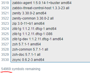

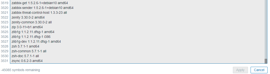

    For more info, testing the item returns all the data to the last package ending at zsync, 3531 lines, length 114,150, ~111kb

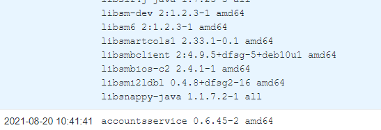

    But executing the item only ends at libsnappy-java, 2073 lines, length 67,667, 66kb to history:

      Checking the row length of the table:
      select value,length(value) from history_text;
      returns:
      libsmartcols1 2.33.1-0.1 amd64
      libsmbclient 2:4.9.5+dfsg-5+deb10u1 amd64
      libsmbios-c2 2.4.1-1 amd64
      libsmi2ldbl 0.4.8+dfsg2-16 amd64
      libsnappy-java 1.1.7.2-1 all | 65535 |
      So 65535, which brings me back to custom script limit - https://www.zabbix.com/documentation...m_script_limit
      Do I need to change form mysql to postgres?

              This reference sets the length in the test item popup, so I no longer get minus figures when running the test now I've set it to 165535.
              However, the history log values are still truncated.

                Ok looking at the zabbix github -
                Real-time monitoring of IT components and services, such as networks, servers, VMs, applications and the cloud. - File not found · zabbix/zabbix
                186 #define HISTORY_TEXT_VALUE_LEN 65535
                187 #define HISTORY_LOG_VALUE_LEN 65535
                I'm guessing it's this?
