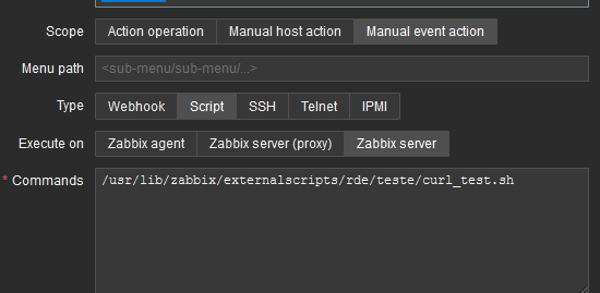

    In Zabbix, I use the following line to start the script:
    /usr/lib/zabbix/externalscripts/rde/test/curl_test.sh
    Click image for larger version  Name:	script_command.PNG Views:	0 Size:	12.8 KB ID:	430368
