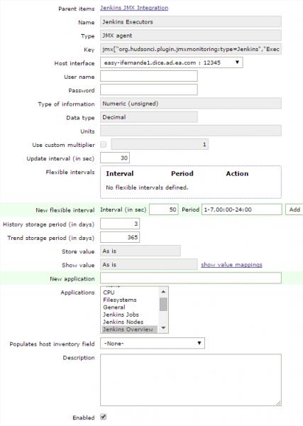

    As an example, here is the config of one of the items included in the template from the Jenkins plugin:
