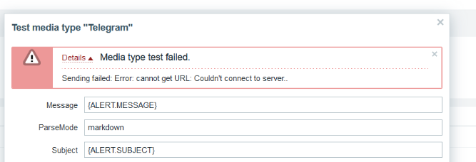

      I am getting error while sending telegram alerts using zabbix UI.
      Please note that i am using proxy in between and able to send test message using curl but not able send test alert using ZABBIX UI. Please find the attached screenshot of the same.
Name:	Screenshot 2023-10-31 13593677.png
