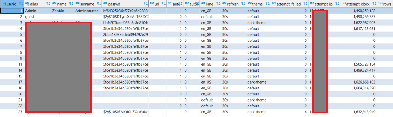

        I did check the database, but I didn't see what would be wrong with it. I attached a screencap.
        Click image for larger version  Name:	loginfailed1.png Views:	0 Size:	91.6 KB ID:	432370
        Click image for larger version  Name:	loginfailed2.png Views:	0 Size:	154.9 KB ID:	432371
        The new account is on the bottom of the table, I don't see what could be wrong with it. All the new accounts I created (deleted already) have looked the same, but still couldn't log in with the password I set for them.

          Ok, thanks for providing that information. I didn't think the Audit report would solve the mystery, but it's always worth checking that first, since it's easy to do.
          I have a theory, but it's just a guess.
          If you look at the encrypted passwd column (which I probably would have obscured if I was going to post it, but I'm glad you didn't in this case), only the guest account and the new account have passwords that start with "$2y$10$". All your other passwords are just 32 bytes of hex characters, but the new one isn't and the guest password isn't.
          "$2y$10$" may just look like any "random" part of an encrypted passphrase, but it's actually not. A lot of encryption routines that work like the Linux crypt() function use the first part of the encrypted password to specify not just a salt but what backend algorithm was used to encrypt the passphrase. You can look at the man page for 'crypt' on a Linux system, specifically the section about "Glibc notes" that describes what the $ section at the start of the encrypted blob actually means.
          The PHP developers decided they liked the selectable-backend for encryption, so they made the PHP crypt() routine work in a similar (but not compatible) way, see: PHP crypt function
          Reading the web documentation for the PHP crypt function, you can identify that the $2y at the start of those passphrases identify the remainder as using the Blowfish encryption algorithm. The $10 after it relates to the Blowfish cost parameter.
          What seems to be going on here is that your older users used Zabbix's original encryption mechanism for passwords, but your new users are getting a new method, possibly because of the version of PHP you're using now.
          I took a quick look at the release notes for Zabbix 5.2 and didn't see anything mentioned about "support for new encryption for user passwords" or anything similar, but I couldn't find any mention of changes there. It might be worth it if you looked through the 5.0 and 5.2 release notes and list of changes, to see if you can spot anything related to PHP encryption or user passwords. I would hope a change like this is mentioned somewhere in the release notes.
          You may also want to look through your php.ini and the pool setting for your PHP-FPM (assuming you're using php-fpm with the web front end), to see if any crypt-related settings have been enabled.
          Something is causing your current version of Zabbix with your current PHP to use a newer encryption method than was used previously, and for some reason this is what's breaking things for you.
          You can verify this by updating the database directly for the new user in question, just as a test. For example, assuming you know the passphrase for Admin or for some other user (like yourself), you can just apply that encrypted passphrase to the new user, something like:
          UPDATE users SET passwd='<the 32 hex bytes from a password you know' WHERE id=23;
          commit;
          and then test logging in as the new user using the passphrase for the user you copied. Obviously that isn't a long-term solution, it's just to test the theory.
            I actually intentionally did not obscure the hash because I found it weird too (you can only see the first half anyway, I didn't show all of it). I guess I was right to suspect something was going on with that, thanks for confirming.
            Actually, I inherited this Zabbix system from another admin, and it was woefully neglected for years. The VM under it was still running 16.04(Xenial) for no reason when 20.04(Focal) was out for months, no updates, no nothing. I actually had to upgrade Zabbix from 3.0 to 5.0 and that caused quite a few problems along with the release upgrade. One of which was the database upgrade to the new engine and of course PHP and everything else. It took weeks to finally get everything up and running, but it was working fine ever since (since last winter). Well, up until I tried to create a new user...
            So somewhere along the way the PHP encryption changed. That actually makes sense, since the hashes looked fishy for me as well. Some users don't even have a hash in DB, which is weird, since they have proper accounts.
            Now, one question remains, if this is a PHP issue or a Zabbix issue? I'll have a look in the PHP and Zabbix settings, but I really would appreciate some pointers.
