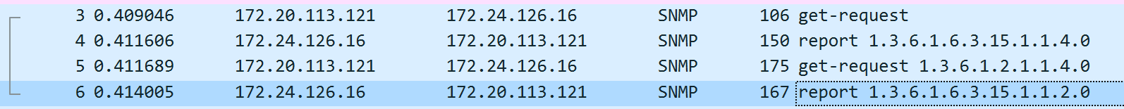

            OK, I am digging deeper into this issue, which has actually started appearing on more hosts. Above is a wire capture of a failed SNMPv3 request from Zabbix on 172.20.113.121 to a Cisco switch. Let's go through the packet dissections.

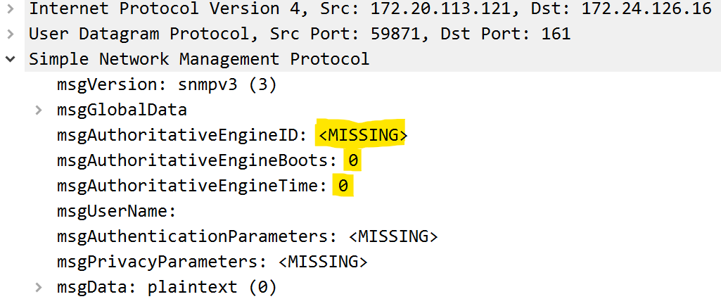

            This is the initial request. All is fine here, unencrypted/unauthenticated packet meant to find out required parameters for subsequent request (EngineID, EngineBoots, EngineTime).

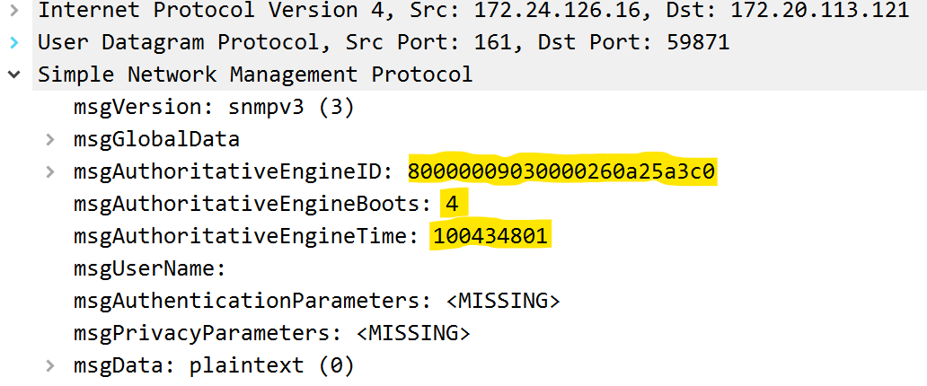

            This is the switch response... plaintext Report packet with required parameters (highlighted). Everything is going well, the response OID is usmStatsUnknownEngineIDs, which is as expected.

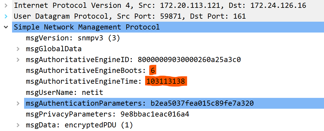

            This is subsequent request from Zabbix server, now it's proper AuthPriv as required parameters are known by this time. But there is the problem. The EngineBoots and EngineTime parameters are wrong: they don't match what we got from the switch, in fact they are wildly off (the standard requires that EngineTime is within +-150 seconds).

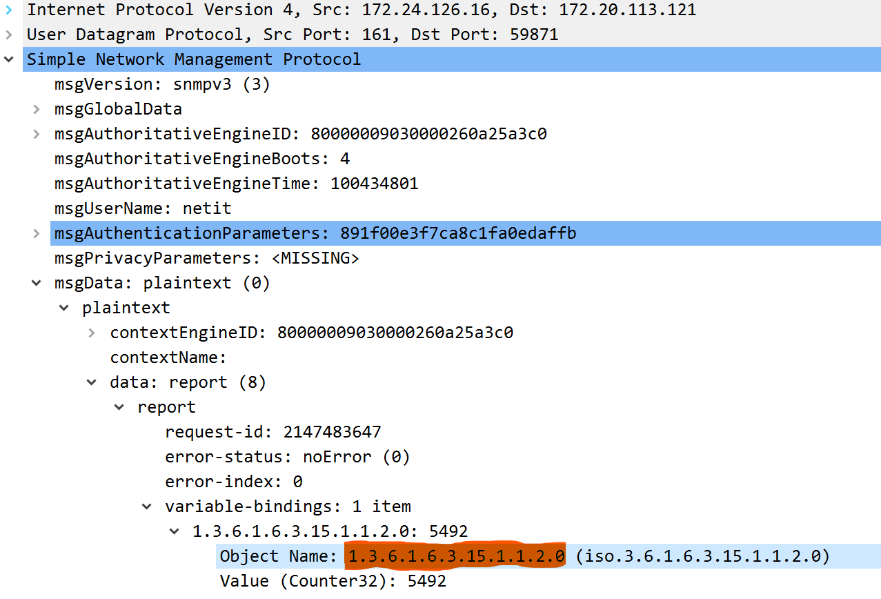

            And of course, the switch responds with another Report PDU, this time indicating the problem. The highlighted OID is the usmStatsNotInTimeWindows error response.
