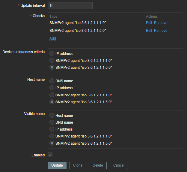

    and the rest of the rule looks like:
Name:	Zabbix-Configuration of discovery rules.png

    Now in this case host X at 172.20.101.98, for example, keeps getting discovered and re-added with _2 appended to the end. The same happens with an identical rule that includes many public IPs, with the same uniqueness criteria and other settings as the rule noted here.
    Two issues:
    1. The uniqueness criteria of iso3.6.1.2.1.1.5.0 is the host's own hostname, so even if Zabbix found the host on a new IP in the rule it shouldn't add it as a separate host but add the IP as a secondary, which it does for some hosts, showing the IP indented below another in the Monitoring-->Discovery list.
    2. The host simply shouldn't even be rediscovered on an IP that is not currently in the discovery rule.
    I am at a loss as to how the deleted IPs are getting rediscovered since they are not in any discovery rule. Disabling the _2 hosts on their secondary IPs is not a good solution because the hosts still show up everywhere and the point is to keep things clean, where the host is only added under the main IP.
    What am I missing, or is this somehow a bug?
    Thanks for any help/insight,
    -Seth

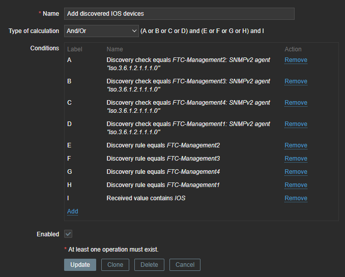

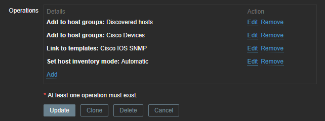

    If it helps, the discovery action and operations (are as follows):
Name:	Zabbix-Configuration of actions.png
Name:	Zabbix-Configuration of operations.png
