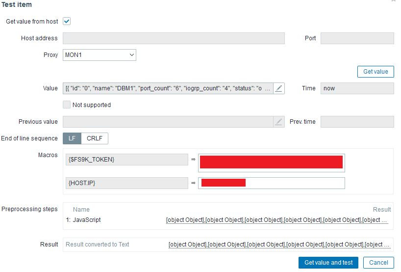

      After running with the latest code with the bug fix above I no longer get the invalid bytecode errors and the crashes. That part is good. However, I can now get no useful data back from the Javascript calls. What worked above in the testing phase no longer works on the new version with the new duktape version.
      Refer to the image above from the test where you could see that the string I expected to be returned was there. Now when I run the same test I get only some string with a bunch of "[object Object],[object Object],[object Object],[object Object],..." values.
      How did this break now? Is this a problem on the zabbix side or with the new version of duktape that is used now?

        This appears to be strictly an issue with dealing with JSON data. I was able to use
        JSON.parse(value)
        and parse the data with no issue as I mentioned above. Is there something different that needs to be done now in order to parse JSON data?

          Ok, never mind the latest issue. It looks like there was still some debug code causing this from when I was chasing the initial problem for weeks. Everything looks good now on s390x when using Javascript preprocessing using the fix above. The code in not in an actual versioned release yet but I built the proxy from a branch that did contain the fix and confirmed everything.
          Issue resolved.
