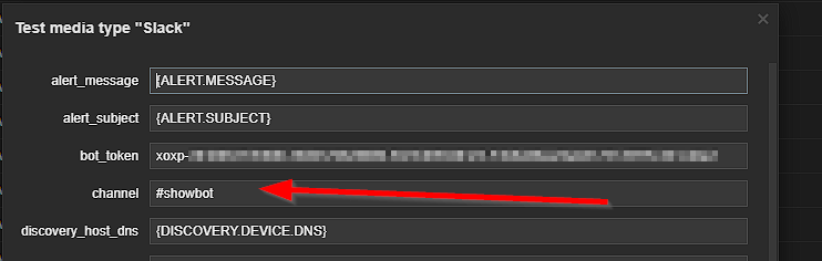

    I had to put the actual url of my Zabbix server in the zabbix_url place holder. So mine reads http://192.168.0.0/zabbix. I get the schema error when I use https instead of http. Still working on the not in channel message.
    • SideSh0wWilly
      • Feb 2023
      I fixed this. Turns out when you test you need to supply a channel name... Who would have know... I guess its a case of RTFM....
