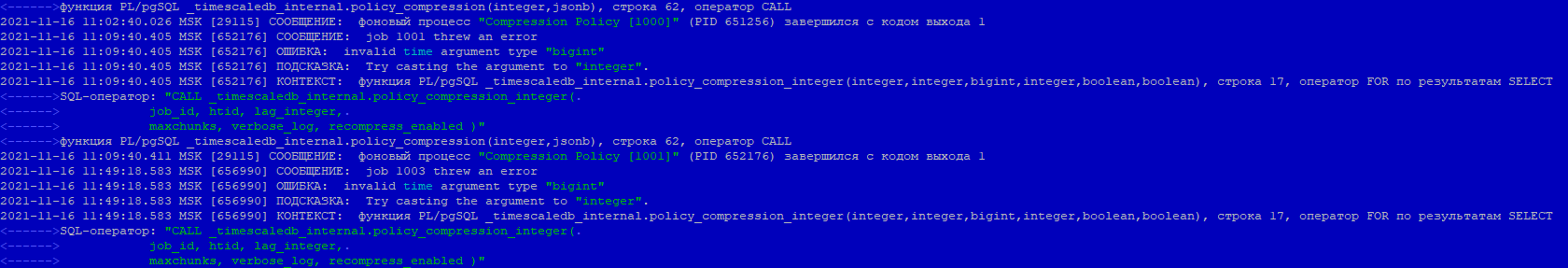

      • Adm20
        • Jan 2020
        • 7
        Now I have this error in the PSQL logs. Yes, PSQL version 12.
