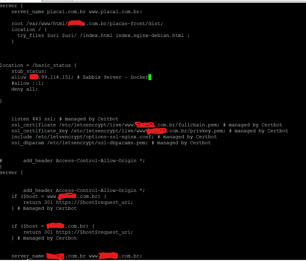

    I'm having problems configuring the monitoring of some nginx items in Zabbix, I tried to do as in https://www.zabbix.com/integrations/nginx
    and it doesn't work the items are like "Not supported". In the images are the configuration of the file
    myhost.com.br.conf in /etc/nginx/sites-available
    I'm using the Nginx by Zabbix agent template for the host

    configuration of myshost.com.br.conf file in /etc/nginx/sites-available

    The 404 error indicates pretty clearly that it's not a Zabbix issue: the URL that you're trying to query is not present.
    If you're using "Nginx by Zabbix Agent", then it would be the Zabbix agent running on the same system as Nginx that would be trying to connect, not the Zabbix server. The zabbix server talks to the zabbix agent running on the same system as nginx, and asks the agent to connect to the URL and return the results.
    Does it work if you add an "allow 127.0.0.1;" and then restart nginx?

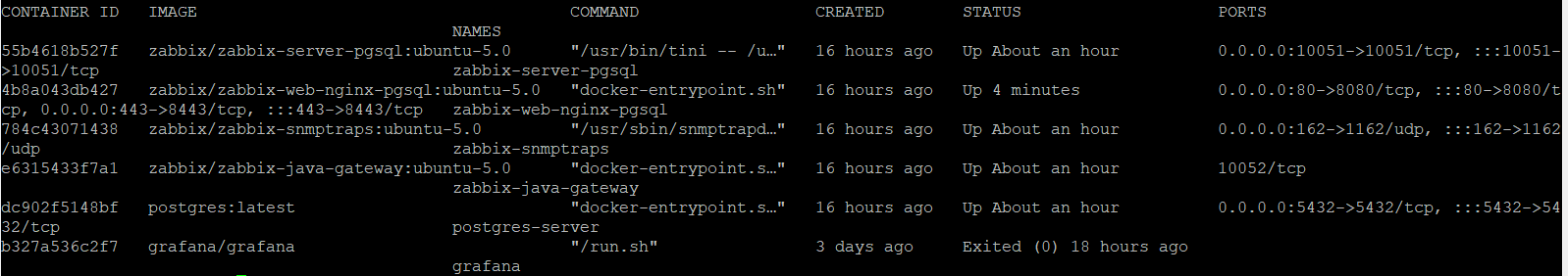

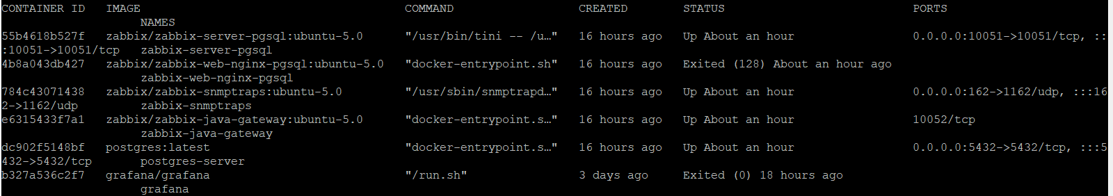

    I reinstalled the containers all with the same version, my new container structure looks like this:
    I still have problems with Nginx monitoring
    I removed zabbix-agent2 from the target host I left only zabbix-agent

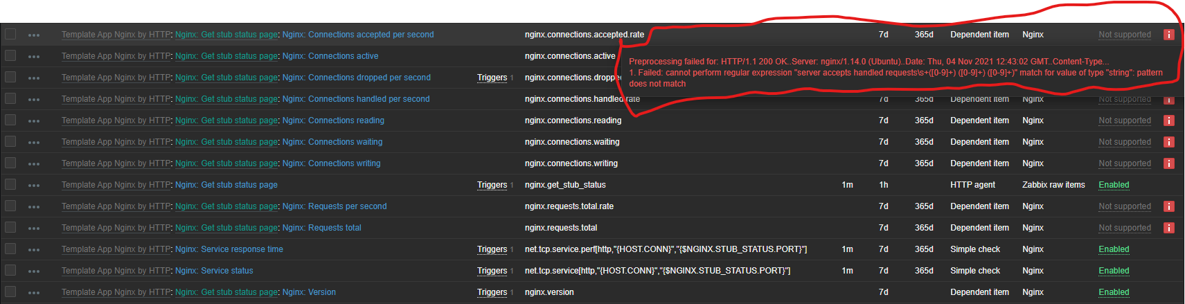

    For the target host in the Zabbix settings I'm using the Template App Nginx by HTTP: Nginx: Get stub status page and it's returning the error in the image below I tried some searches to solve but without success

      Ok, now that you've switched to using the "Template App Nginx by HTTP", the http request is going to come from your Zabbix server (or proxy, if you're using a proxy to monitor this system, but you didn't mention one so I assume not).
      If you look at the macros that you can use to configure that template, you can see:
      Macros used
      {$NGINX.DROP_RATE.MAX.WARN} The critical rate of the dropped connections for trigger expression. 1
      {$NGINX.RESPONSE_TIME.MAX.WARN} The Nginx maximum response time in seconds for trigger expression. 10
      {$NGINX.STUB_STATUS.PATH} The path of Nginx stub_status page. basic_status
      {$NGINX.STUB_STATUS.PORT} The port of Nginx stub_status host or container. 80
      {$NGINX.STUB_STATUS.SCHEME} The protocol http or https of Nginx stub_status host or container. http
      That means that by default, your Zabbix server is going to connect via http. So the URL would be http://www.mysite.com.br/basic_status
      If you log in to a shell on your Zabbix server and use either "wget" or "curl" to connect to that exact URL, does it work, or does it return a 404 status?
      If it returns a 404 status, does it work if you change the URL to use "https" instead of "http"?
      Based on how I read your Nginx config, it seems like the "location = /basic_status" is only defined for the https vhost, not the http vhost. If that's the case, you could either move that "location" stanza into the http vhost or you could override the default value of the macro {$NGINX.STUB_STATUS.SCHEME} in the settings for this host in Zabbix, so that the template uses https to connect, instead of the default of http.

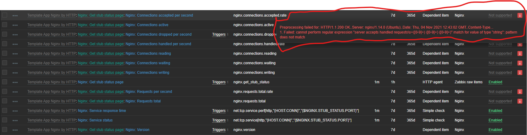

        After configuring this way, it was like this in zabbix

        I changed the Macro setting to https and port 443, I really believe I'm doing it incorrectly

        • um3n
          um3n commented
          I think you cannot access the site from another location then 127.0.0.1 because you bound it to loopback.
          If you check via Zabbix Agent it should be able to access 127.0.0.1 but you have to curl for localhost... i think
