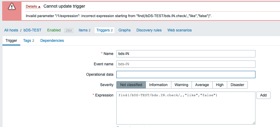

    Setting the trigger from JSON data true / false
    Hey, I'm having a problem setting the alarm trigger for data downloaded in JSON format. It gets true if it works, false if it doesn't. How do I set the trigger?

    Thank you for your interest in the topic. Yes it's just an item validation I wanted to show what I get.
    I am familiar with the documentation of the trigger and unfortunately I cannot cope with it.
    I think. that in Expression I should add ITEM.VALUE = 1, but how?Click image for larger version

      Thanks for explaining how to use a macro. That's exactly how it returns the text, but unfortunately find does not work (/bDS-TEST/bds.IN.check / "" like "," false ")

          Cyber, I was able to make the trigger in this configuration:
Name:	Zrzut ekranu 2021-11-4 o 10.39.36.png
          I think we can close the topic, thank you for your help
