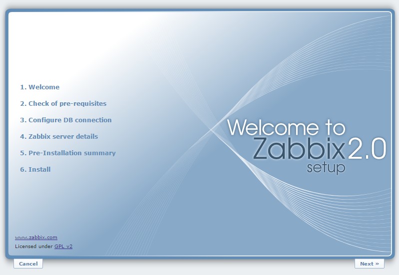

zabbix 2.4.6 installed by package but frontend setup is 2.0 !!!!!
  • mersiuse
    • Feb 2014
    hi all
    i installed zabbix 2.4.6 from
    with below rpm
    rpm -ivh http://repo.zabbix.com/zabbix/2.4/rh...el6.noarch.rpm
    [root@SPSK-VM01-1442 create]# rpm -qa | grep zabbix
    zabbix-release-2.4-1.el6.noarch
    zabbix-web-2.4.6-1.el6.noarch
    zabbix-server-mysql-2.4.6-1.el6.x86_64
    zabbix-agent-2.4.6-1.el6.x86_64
    zabbix-web-mysql-2.4.6-1.el6.noarch
    zabbix-2.4.6-1.el6.x86_64
    zabbix-server-2.4.6-1.el6.x86_64
    but after installing the packages and config php and ...
    when i'm trying to fronted
    splash screen is for zabbix 2.0 !!! and installation process seems related to old version, how could it be possible ! and how could it be solved ?!

    Check your web browser config. Try "locate setup.php" on your web server (make sure mlocate db is current), look for an old copy of the web bits that apache is using.
