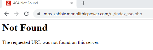

    I have some issues configuring Zabbix (version 5.4) with OKTA as SAML. The configuration seems to work fine and it does the OKTA redirection just fine, but when I input the OKTA credentials and they are OK and I am being redirected back to zabbix, I get a 404:

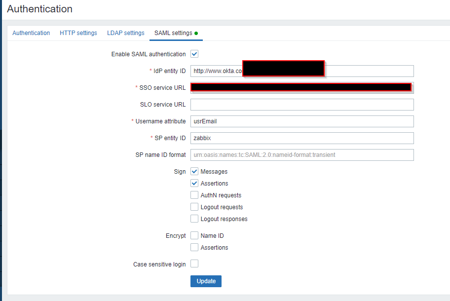

    I've followed the documentation and this is the current configuration I have on Zabbix for the SAML options:
    Any ideas where the error might be? Have I missed something?

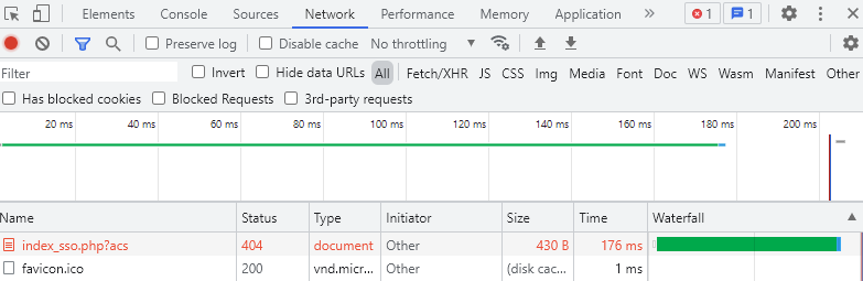

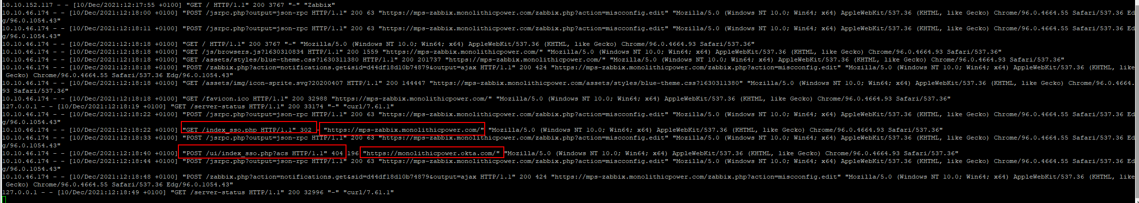

          We are using Apache httpd. We are not running it behind a proxy. I did the whole SSO authentication process, including the notification from OKTA and here are the logs from the webserver, where you can see the 404 and 302 issues:
          Which is pretty much the same info we get from Chrome's Network Console:
          Is there any other information from my side that can help debug this topic?
          Best Regards.

              /ui/index_sso.php is also giving a 404:

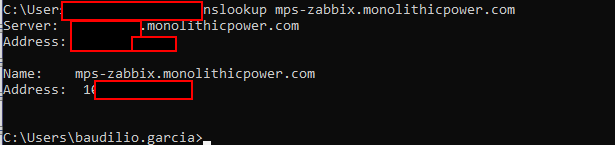

                Have you setup a DNS entry for mps-zabbix.monolithicpower.com?? the subdomain does not resolve for me.
                • bagahe
                  • Nov 2021
                  • 15
                  Hi Steve,
                  Yes, it´s definitely reachable from the internal network:
                  Best Regards,

                    Looking at the URL in the screenshot, you're trying to go to mps-zabbix.monolithicpower.com/ui/index_sso.php. Looking at my zabbix install the ui directory doesn't exist and the index_sso.php in the / dir so mps-zabbix.monolithicpower.com/index_sso.php with our the ui sub folder.
                    Originally posted by bagahe
                    Hi Tim,
                    No, we are using PHP-FPM, I meant that the the service is not running behind a reverse proxy or anything like that.
                    Click image for larger version  Name:	404_php.png Views:	6 Size:	11.9 KB ID:	436507

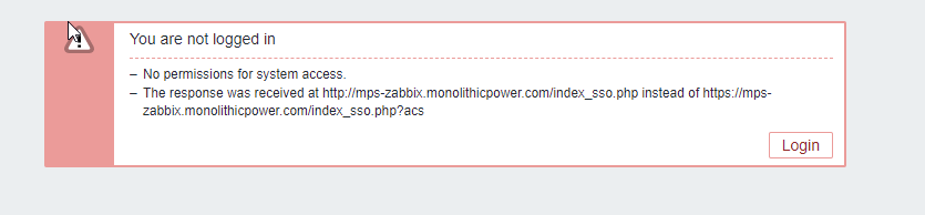

                      I´ve changed things to match the documentation and it looks like I have some progress, but still stuck on URL redirection after OKTA authentication:

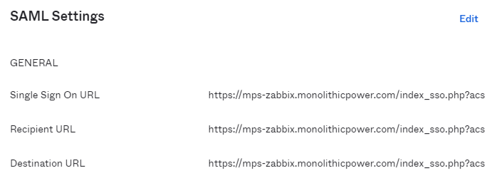

                      These are the settings I have on OKTA SAML:
                      Thank you very much for your help so far.

                        TBH I've not used any SAML soloutions "yet" is there any settings withing OKTA? the error message seems to points that http is being returned to instead of https.
