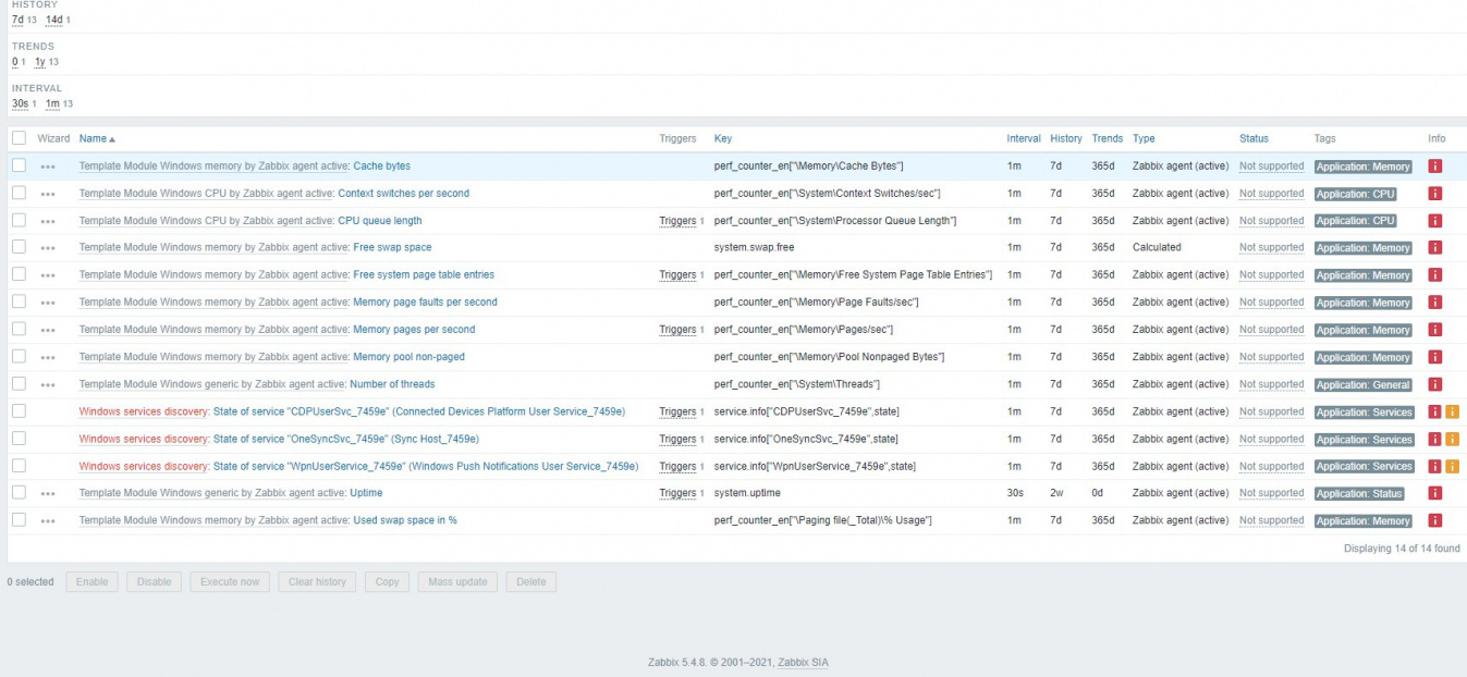

    Im new on this forum so hi to everyone.
    I have problem with one pc which i want to monitor. On that pc is installed Zabbix agent 2 v5.4.8, and server is Zabbix 5.4.8. It is updateed to latest version but i had same problem on older versions.
    I have error that some perf_counter are not supported by the os. But still some are working fine. So i checked on log which counters are problematic. Picture in attachment is with selected not supported items.
    Checked register on host os (HKEY_LOCAL_MACHINE\SOFTWARE\Microsoft\Windows NT\CurrentVersion\Perflib\009\Counter) and every one of that "not supported" counters are there, with same name. I tried to repair perf counters, and i did that, but problem is still the same.
    Also i tried to test on the host pc with perfcounter id instead name, but error is the same (zabbix.exe -t perf_counter_en["\8\818"] ).
    I put zabbix log with highest debbug on link because i cant upload it here. So any suggestion is welcome what else can i try. Thank you.

      I see lines like:
      cannot add performance counter for CPU load statistics: The specified object was not found on the computer.
      failed to execute exporter task for itemid:52919 key 'perf_counter_en["\Memory\Page Faults/sec"]' error: 'The specified object was not found on the computer. '
      So i think the problem is in the Windows system. Maybe try suggestions form M$:
      https://docs.microsoft.com/en-us/tro...mance-counters
      https://docs.microsoft.com/en-us/tro...library-values

        Agree with you, i also suspect that Windows counters are maybe corrupted. I tried that few days ago, but no luck. Error is the same.

          Ok i found solution. Perf counter was disabled by Windows. I enabled it and restart zabbix agent and everything is working fine now.
